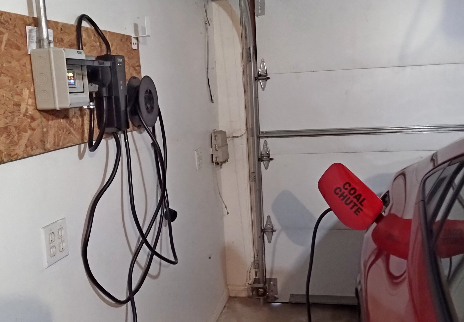

    Then you missed my post, now charging with a charger DESIGNED for 220 AND a kilowatt monitor so I know how much juice I'm using.
    You spent 45,000 for a car and can't spend a few hundred for the correct electrical components to charge it safely?

    I think it was the factory wall charger that smelled, by the time I was back to the garage everything was cold. The circuit and cord I used has and still does run 2HP electric motors it is fine to handle a load.
    The factory charger still works fine. But I now use the Vevor 16 amp 220V wall charger on a dedicated 20 amp circuit (10-2 wire) plus a Kilowatt hour meter to keep track of electricity used. Just FMI.

  18. gggGary
    gggGary gggGary
    Dec 2, 2007
    79
    Baraboo WI
    2023 Prius Prime
    XSE Premium
    Amazon
    KETOTEK Single Phase Energy Meter Din Rail Electricity Usage Monitor AC 40-300V 100A Voltmeter Ammeter Watt Kwh Frequency Power Meter Built-in CT 110V
    in this enclosure
    smseace Distribution Protection Box, ABS Plastic Transparent Cover Waterproof Distribution Box IP65, for Indoor Wall Circuit Breaker (5 Way)
    it senses one leg but read outs in KWH @ 240 volts
    RandyPete likes this.

  20. gggGary
    gggGary gggGary
    Dec 2, 2007
    79
    Baraboo WI
    2023 Prius Prime
    XSE Premium
    look at my first post I copied the product info so you can search and find them on Amazon.
    The watthour meter $26 in the enclosure $15
    I'm having no luck with pics and links on this forum on firefox.
