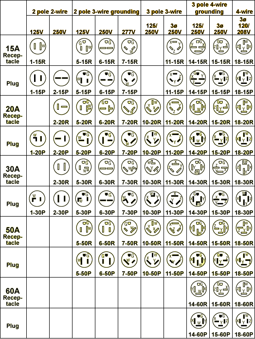

    Here is North America 240 volts is rare and 'industrial', we forget that every plug in Europe is 230 volts and they do fine. The manufacturers all have experience in Europe. It is hard to bring to America because 'plugs'.
    Look at this mess:
    And then there are 'locking' outlets!
