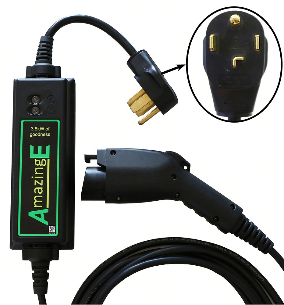

    I am not finding any right angle at the car end cables, but at the 220 v plug end is this:
    amazon.com/AmazingE-Portable-Electric-Equipment-Connector/dp/B06XSLYDLH
    I am not finding a 110v level 1 cable with a right angle plug.
