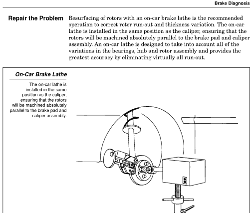

  19. ChapmanF
    28,721
    19,020
    Toyota's training materials describe "turning" rotors as "the recommended operation to correct rotor run-out and thickness variation." Naturally, they recommend replacement if the issue is that the rotors are worn near the minimum thickness.
    They are silent on what to do if the issue is excessive rust, but if the overall thickness is ok, resurfacing does a nice job in my experience.
    jerrymildred likes this.
