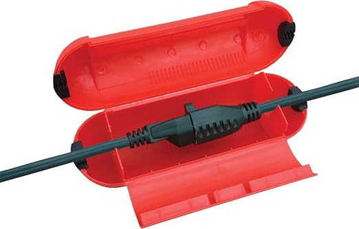

    There are a couple of types of weatherproof extension cord connector boxes:
