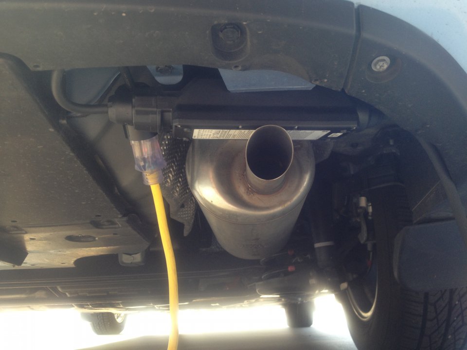

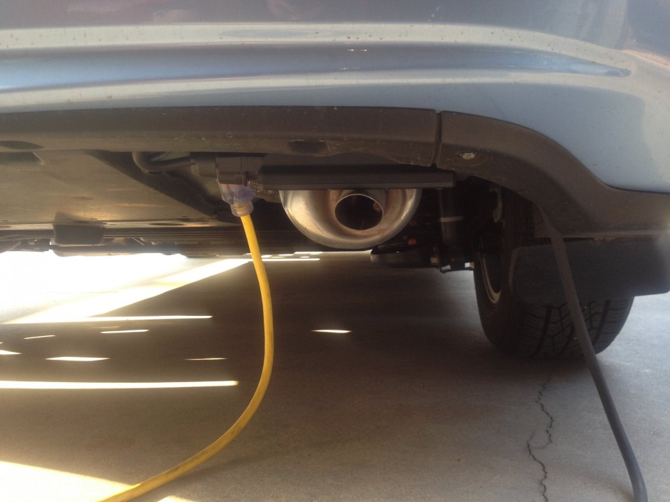

    I charge in the rain. I've found that there's a clever spot above the exhaust where the block fits perfectly, protected from the rain. Just ensure that the muffler is not hot. image.jpg image.jpg image.jpg image.jpg
