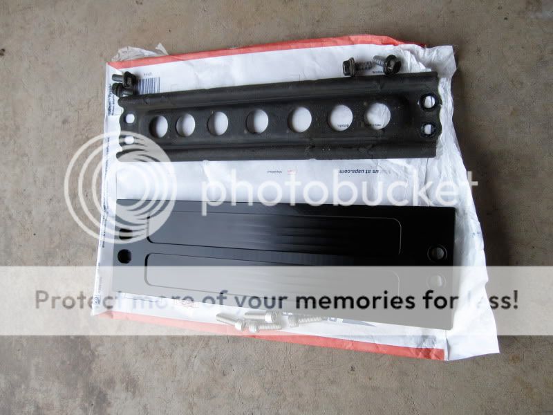

  14. don_chuwish
    don_chuwish Well Seasoned Member
    May 1, 2009
    823
    190
    Southern Oregon
    Mine arrived midweek and upon tearing open the package my first impression was "wow, simple bit of CNC work here". You can still see the marks from the cutting head and all, not an overly refined job but why would it need to be? Gonna be under car covered in crud anyway.
    But even before it arrived I'd started to have buyer's remorse, thinking it was too much of an impulse purchase and probably won't make any difference in how the car feels. Classic case of seeing a product that solves a problem I don't have. But I'm a sucker for a cheap and easy mod, tinkering for the sake of tinkering.
    So without any expectations I put it on today after work. Some notes from this experience:
    • I feel like it's smart to park on level ground, my garage was perfect for me.
    • 12mm socket to remove the bolts on the factory brace, they're not very tight, easy to remove just sticking your arm out while lying on the floor next to your car.
    • 6mm hex (allen) to install the bolts that come with the new brace. I have a fairly long one from my cycling tools (Park). Made it easy to apply enough pressure. Don't really need much.
    • As you can see in the pictures, holding the brace up near the frame with something helps start the bolts easier.
    So after it was on I took it for a short spin. Then went longer as I realized I needed gas anyway. Just backing out of my driveway felt different. As I back down and turn out of my driveway there is a lot of side to side rocking which helped highlight the difference.
    "Less plush" could describe it just as easily as "more responsive" - that's always the challenge I guess. On the road and freeway it did feel more solid, tied together, whatever. Lane changes at 65-70mph felt more crisp. I'd never had any complaint about handling with the Prius but I think I like this cheap and easy mod.
    - D
