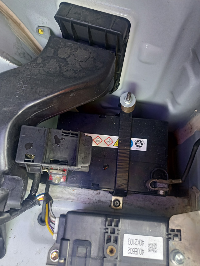

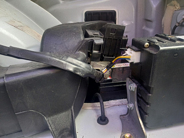

    I bought a car at an auction with a dead 12V battery.
    I didn’t want to pay 200 bucks for a new one, so I decided to look for replacement options.
    I noticed a 12V 35Ah AGM battery in the HF and figured it was the right size for a Prius.
    I bought the battery and installed it without any significant changes.
    It was necessary to unscrew the positive 12V terminal and slightly change the top mount of the battery.
    Before installation, you must charge the battery!
    I've been using it for 5 months without any complaints.
    NOT suitable for colder states! In cold weather, the battery releases its charge worse.

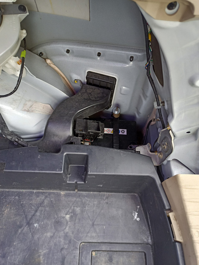

    Can you post a photo of how well your floor inserts fall back into place with your new battery?

    My trunk has been disassembled because I am currently testing my development - a lithium high-voltage battery. I think I'll make a post in a couple of weeks when the prototype of the 3rd version is ready.

    This is a maintenance-free battery and it does not need ventilation, as well as topping up the electrolyte or distilled water.
    In any case, time will tell how long it will last.

    Was hoping you would post a photo of the floor piece that covers the 12v battery, along with the rest of the floor installed. Curious how out well it aligns compared to OEM. But, if you don't plan to ever have those components installed, I suppose it doesn't really matter much.
