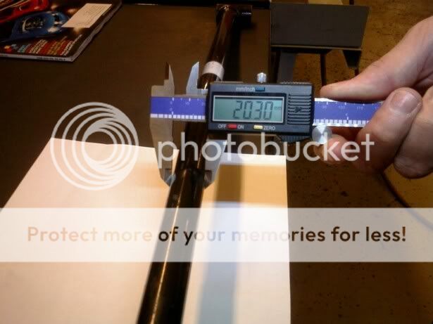

    The 9th gen Corolla bars will fit. The rear is 20mm.[​IMG]
    The front however is 24mm. I've had them all on my '08. I'm currently running a TRD rear bar with the OEM Prius front bar. I autocross and the Corolla front bar caused too much understeer while racing however, was AWESOME on the street. You probably won't notice much difference using the OEM Corolla rear bar. If I remember correctly, the Corolla bar is solid whereas the Touring Prius bar is hollow. The only issue I've had with the TRD rear bar was the bar shifting in the beam after a few hundred miles. I installed Corolla mounting bolts and this solved the problem. Feel free to ask any other questions you may have.
