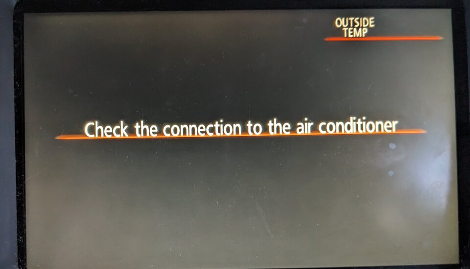

    Greetings,
    Replaced the evaporator in my daughter's 2008 with smart key and back up camera. The car ran fine when I started it up yesterday, other than a leaking heater hose on the engine side of the firewall. Fixed.
    Once this was displayed, I took the dash apart looking for a loose connection, but none were seen. Any ideas? Will my Techstream help to track this down? I haven't connected it up yet. No codes.

    You haven't connected what up you you mean hoses and refrig in ? Or things still unplugged?

    Maybe it sees no pressure yet .I'll look in manual for this character display.

    I think I've seen that previously when all the connections are not on the back of the MFD. I'm sure there could also be other causes.

    Yes. That's the ironic thing. This message just appeared. Car runs fine, just unable to access or control the AC. I'm going to check it again tonight when I get home and try to locate that fuse. Seems odd.

    If techstream can connect to the HVAC ecu, report any codes. Otherwise if connections at the ecu and MFD are in fact secure, then I would suspect an internal MFD fault.

    I am finally able to get back to this. I let the car reset a couple days. HV unplugged. 12v unplugged. Reconnected both and tried the AC. The display is still unable to connect to the AC..
    AC Auto and temp control buttons on the steering wheel work. I didn't run it long. I still have to add refrigerant and compressor oil.
    Faulty display? Any suggestions?

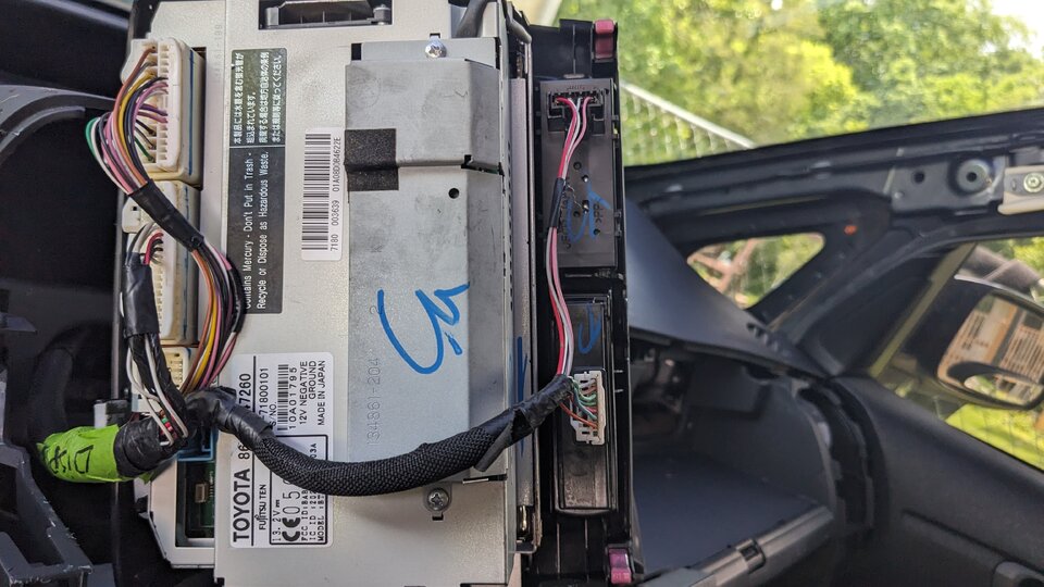

    I have attached a photo of the 4 connectors going into the back of the display from the harness. All buttons on the left of display screen: display, info, climate and audio all change when the button is pushed.
    Is anything missing?

    Looks like loaded w GPS ? Looks fine I believe mine's same w these options
  17. Tombukt2
    Tombukt2 Senior Member
    Nov 29, 2020
    13,860
    2,519
    Durham NC
    The middle wide white plug is the magic to operational MFD the other plugs I guess are the many inputs from car that middle plug is always same others might be different w varying options or such . Most MFD will power on with just that middle plug inserted for testing
