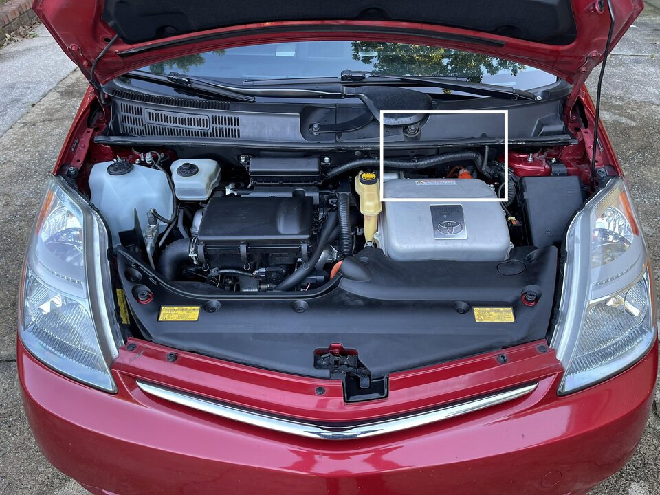

    Here is a gen2 engine with hidden brake booster area highlighted.
    Danica and Dennis Brown like this.

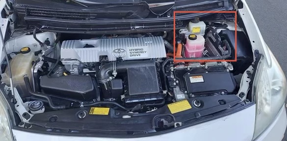

    The thermos pump runs after the car is turned off, but it does that on a hill or not, and the sound I hear is from the pump not from the fluid at all. Perhaps if there was a big air bubble a sloshing might result. Is there a reference mark on the coolant overflow tank on your car? That is the clear white tank just posterior to the radiator on the passenger side. If there is a mark, is the coolant still at that reference mark (when the car has been off for a while and is cold). If there is no such mark and the coolant is more or less in the middle of the tank, take a sharpie and mark that level. It shouldn't change (when the car has been off overnight, parked on the same surface) unless there is a leak somewhere. Coolant leaks can sometimes let in enough air that sloshing sounds result, and I suppose the angle of the car could affect that. Typically the sound would come from the heater core, which is in the cabin, so gurgling noises there are easier to hear.
    The inverter coolant tank is the yellowish thing next to the big shiny metallic inverter. Coolant level for that is marked on the plastic near the top. In general terms it should have pink coolant in it up to very close to the cap on top. If that coolant was low I suppose you could get a sloshing sound too.
