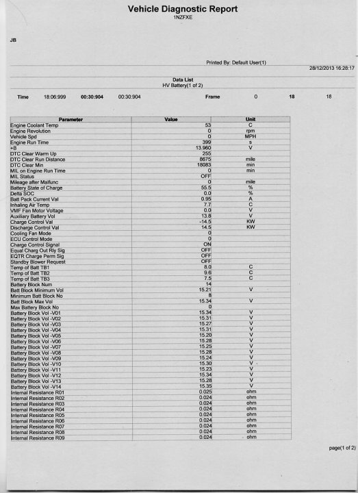

  5. Britprius
    Britprius Senior Member
    Jun 14, 2010
    5,194
    1,924
    Herefordshire England
    GC see below for first page of HV battery printout from Mini VCI.
    John (Britprius)
    GrumpyCabbie likes this.
