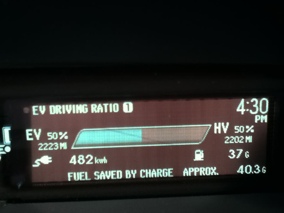

    Go to EV Driving Ratio screen. Take the gas miles divided by gallons consumed.
    In this example screen, 2,202 gas miles / 37 gallons equals to 59.5 MPG.

    and make sure you reset the evdr1 or 2 for the intended measurement, trip, tank, lifetime.

    Since that includes electric miles, the result is not fuel economy but rather "gas consumption". PiP calls it consumption MPG.
    To get gasoline fuel economy, take only the gas miles and divide it by 8 gallons.
    Ditto for electricity fuel economy, electric miles divide it by kWhs.
