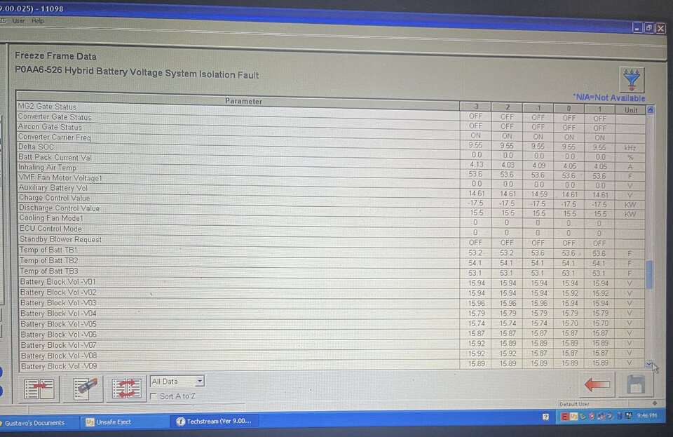

    I have techstream and have the following readings. I’m not too familiar with techstream can someone maybe point me where to start isolating and checking for ground.
    Thank you

    What version of Techstream are you using?
    Can you make a screenshot showing all the systems and errors for these systems?
