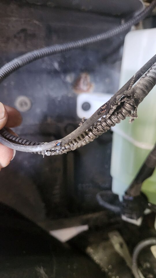

  18. Eug
    Eug Swollen Member
    Jan 13, 2004
    970
    223
    2025 Camry AWD
    XSE
    Pre-collision system light came on again. This time it was the front right speed sensor. My mechanic traced the wire and found it to be damaged. The sheath was partially stripped, with the wire exposed. This is undoubtedly due to the prior collision I had that involved that area. The mechanic fixed the wire and the PCS light is gone again.
    I'd upload a picture but this site isn't letting me do it.
    I wonder if this could have caused the rear sensor errors mentioned in the last post, but there was no front sensor error at that time. FWIW, he said the bearings for those rear wheels were near the end of their life (humming) and needed to be replaced anyway.
  19. Eug
    Eug Swollen Member
    Jan 13, 2004
    970
    223
    2025 Camry AWD
    XSE
    Here we go. This is the damaged wire that was causing the PCS warning light to come on.
    Well, you sort of called this one. Yes, it was related to the accident, but it was because it caused an intermittent disconnect in the circuit to the right front speed sensor.
