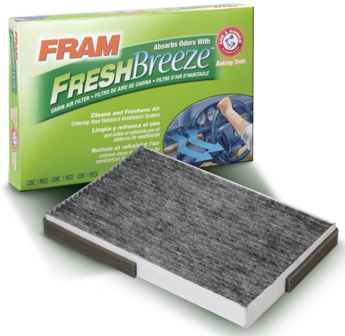

    the FRAM freshbreeze cabin filter (available at walmart $17) seems to be a "more significant" filter...hopefully it helps stop the filthy diesel carcinogen fumes from getting in my car!
