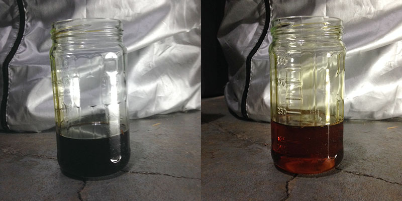

    Did a 6 month or 8000 km (Canadian interval) change this morning, 6 months governed, and the kilometers since last change was only 4058. Here's how it looked, before and after:
    I know, may look dark, just means it's doing it's job. Still, just saying.

    2500 miles and your oil looks like that? you need to drive more.

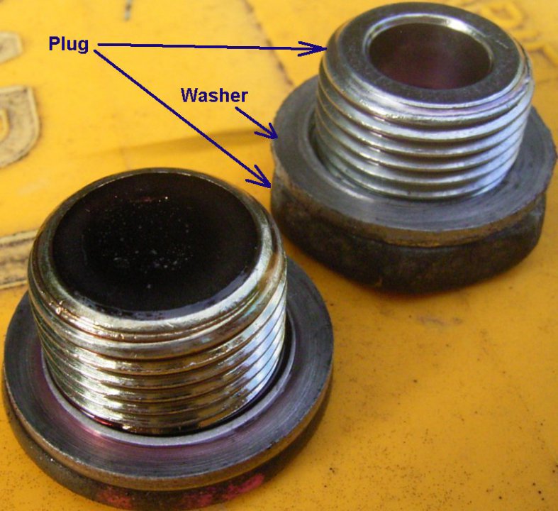

    Hi almostrice. It's fairly common for people to not notice the washer because it tends to get stuck permanently onto the drain plug, particularly if it's been over torqued. By design these washers crush and deform when you torque up the plug, and this can cause it to squish into the threads of the plug and stick there. It's actually quite common for people to have an old washer squashed onto their drain plug and never even realise that it's there.
    Here's a picture of what a drain plug and washer looks like. This particular one is from my transaxle, but the situation is fairly similar with the engine drain plug. These ones are in pretty good condition (and not stuck), but if someone's been using the same engine drain plug for many years then the washer and plug are usually fused together as what appears like a single unit.

  12. almostrice
    almostrice Atari Rocks
    Aug 13, 2009
    16
    Houston
    Sure are a lot strong opinions on this. I have never had a problem. Seems like you dont clean your mating surfaces and require a crutch such these washers. I have changed my oil for 25 years. I have never saw the need for washers. Keep your opinions as opinions. If they were needed, the manufacturers would have used them when I got them new.
    Also, I am not blind. I know what washers look like. Those look like they were overtightened by some grease monkey.

    Our mileage has a fair number of long trips, we're in the 'burbs. Also, I'm cognisant of the toll of short runs, we don't do impulse drives unless unavoidable. And use a block heater year round.
    If I look at the dipstick just prior to oil change, the oil looks very clean: oil appearance is deceptive in such a thin film.If you ever get an early oil change, catch a cup or so in a clear container: I think you'll be surprised how dark/opaque it looks. Again, likely the oil is just fine, just doing it's job, but it's an eye-opener. ;)

    Your car-your money-your problem....however your 2005 Gen II Prius reqires part number 9043012031 washer/gasket on the oil pan plug and my 2010 Gen III Prius requires the same. That is fact, not opinion...so as you say "keep your opinions as opinions"...and for the record, I have been a licensed mechanic longer than you have been changing your oil in the driveway, backyard or where ever.

    Look almostrice, I was trying to be nice and show how yours was an easy mistake to make. I was actually trying to help prevent you from looking quite so foolish. But seriously, there’s just no helping some people.
    And just a bit of a “heads up” for you. Opinions that you can take photos of, those are actually called facts.
