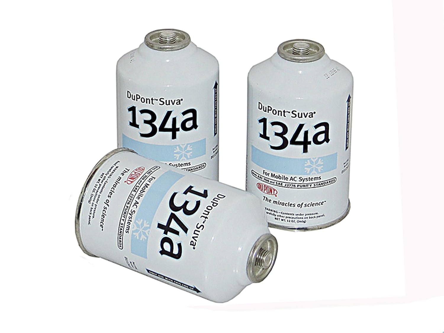

    I bought this last week, it's currently out of stock but should come back soon enough. R 134a R134 A C Pro Hybrid Vehicles Refrigerant | eBay

    • Compatible and safe for all hybrid vehicle A/C systems
    • Improves dielectric performance of older electrically-powered systems
    • Recharges lost R134a refrigerant and safely seals minor leaks
    • Restores lost oil and boosts cooling system
    • For use on all belt-driven, electric, electric and mechanical/electrical combination A/C compressors
    • obviously it has some sealant in it, which is not much appreciated by ac shops/
      how would it 'improve' the dielectric performance?
      the type of oil is not specified/
    • so I don't know, but I would just go with plain r134a....
