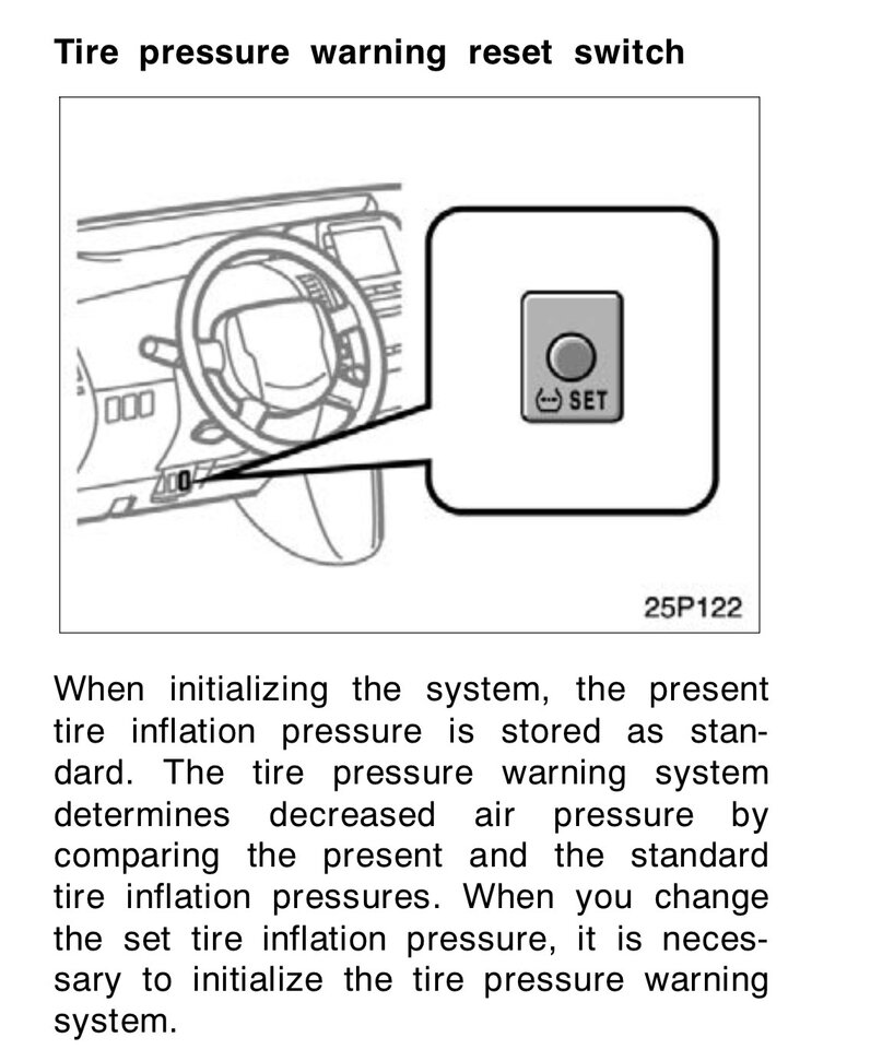

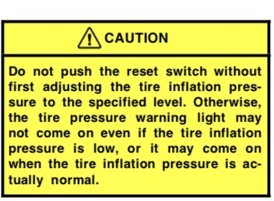

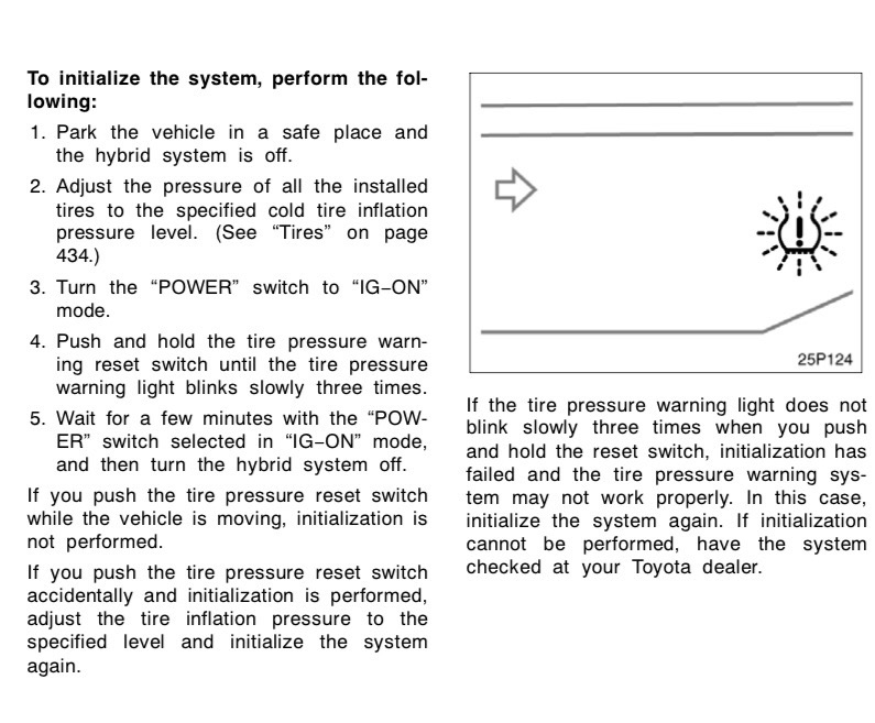

    I set the TPMS alert threshold much higher than normal. The way it's set (in my generation, gen 3, anyway) is by pushing a button under the dash, and then it looks at whatever pressures the tires have now, and sets the alert threshold for a substantial percentage below that. Like, if I pushed the button when my tires at at their normal pressures, I would never get alerts unless they dropped into the mid-20s psi.
    So instead, I pumped my tires up just once to the max sidewall pressures, and I pushed the button then, and after that I let them back down to the pressures I normally run.
    That means I get the yellow TPMS light when they're just a few psi below my preferred pressures, and I air them up right then.
    It can be a bit of a nuisance in the spring and fall when temperatures change a lot, because every sharp temperature drop lowers the pressure enough to put the light on again. But then, I wanted to know about that, so I guess that's what I signed up for. :)
