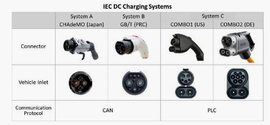

    What style of DC connector?
    Are GM dealers going to establish a nationwide network of chargers?

    I think they're going with CCS (Combined Charging System) that the Europeans are going with.

    Sorry to hear about the "Combo 2 DC Plug" as it is incompatible with the SAE-combo use by my BMW: EV DC Fast Charging standards – CHAdeMO, CCS, SAE Combo, Tesla Supercharger, etc | The Long Tail Pipe
    <SIGH>It appears there is a pattern that no consistent DC charging plugs will ever exist. Each manufacturer is pretty well making their DC plugs unique. I suspect there is a business opportunity here.

    No, no, no. The Bolt will have the same "Type 1" SAE CCS DC plug as your BMW i3. The Opel Ampera-e version of the Bolt EV will have the same Euro "Type 2" version of the CCS plug as a European BMW i3. Same goes for VW group (Audi) cars and Mercedes etc.
    Essentially only Nissan is selling cars with CHAdeMO plugs in North America and Europe. Mitsubishi sells some on their Outlander PHEV. Hyundai/Kia appear to be switching to CCS for DC.
    VW is probably going to spend much of their EPA/CARB $200 million a year for 10 years for zero emission infrastructure fine on installing high speed CCS/CHAdeMO DC charging stations that can run at 200A+. Those stations can charge any car that is DC capable (Tesla via an adapter).

    CCS and no. GM is investing a minimal amount into charging infrastructure, if any. I suspect this is a bone for the dealers.
    I believe Nissan has already announced the next gen Leaf will be in the 200 mile camp, and I am hoping the Ioniq BEV will be near $25k.
    Yes, Tesla will retain the edge when it comes to buyers wanting a BEV for long trips.
    The Combo 2 CCS plug is only used in Europe, and that is due to the fact that they use IEC type 2 for AC level 2 charging instead of the SAE J1772/IEC type 1 plug that we use in North America. Considering that the basic wall outlet between the two regions isn't the same, it would have been a miracle to get the same plug type used for plug ins in those regions. Plug shape aside, it is the same CCS standard.
    The CCS outlet on the Bolt will be the same CCS outlet on your North American i3.
    While having two different, "open source" standards is annoying, it isn't as bad as the betamax/VHS or BlueRay/HD DVD conflicts. It isn't relevant to home chargers, and the extra cost of having both plugs on a public DC level 2 charger is small compared to the cost of the charger and installing it.
    Tesla has their own standard because Chademo was the only standard finalized at the time, and it wasn't fast enough. I wish another car maker would buy into the Supercharger standard. I think it is the superior one because of the flexibility in outlet options. And until VW builds their 300kW charger, it is the fastest.
    While Tesla doesn't offer a CCS adapter, they did join CharIN, the European manufacturing group promoting CCS there.
    Combined Charging System - Wikipedia, the free encyclopedia

    Thanks! I get so tired to reading about the three different styles of chargers. In one respect, I can understand the Nissan and Tesla decisions. They needed to ship product. But anything other than the SAE combo "SAE CCS DC" is truly nuts.
