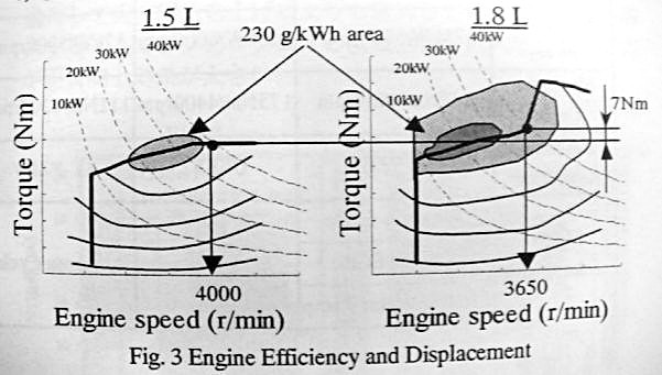

    We'll have to agree to disagree about this because a clutch has mass and more moving parts that are not in the HSD. There comes a point in a design when 'perfect becomes the enemy of good enough.' Understand I won't complain if Toyota is able to shim-in a clutch on MG1 and get a direct drive at a fixed gear ratio. Let me explain the engineering trade-off.
    A high-speed, lock-up means the engine operating line becomes vehicle speed and load constrained allowing (forcing?) the engine to operate in inefficient ranges:
    • HSD - engine at peak efficiency, some transaxle loss, fewer parts, less weight, wider engine rpm/torque range following peak BSFC
    • lock-up HSD - engine at lower than peak efficiency, less transaxle loss, more parts, more weight, engine rpm/torque follows vehicle speed and load constraints
    Notice the "Fixed Ratio" is a 'flat line' that fits in the BSFC chart of the Chevy tuned engine. The BSFC chart for the 1.8L engine is different and the operating line follows the peak BSFC efficiency region:
