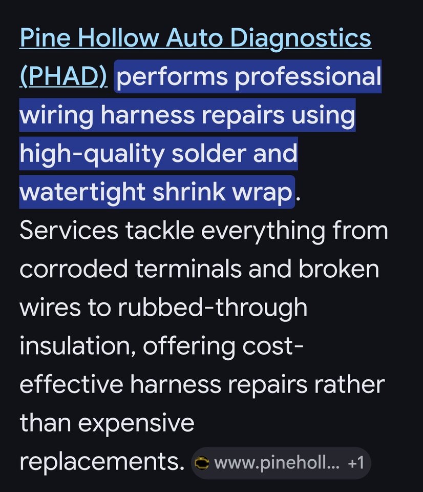

    In terms of wiring repair skills, I like the methods youtube's Pine Hollow Diagnostics uses for soldered wiring repairs. His videos are not specific wiring how to oriented. You will get some advice here to use only the solder butt splices but I think they are best suited for small one or two connections. You are dealing with a life safety system here.

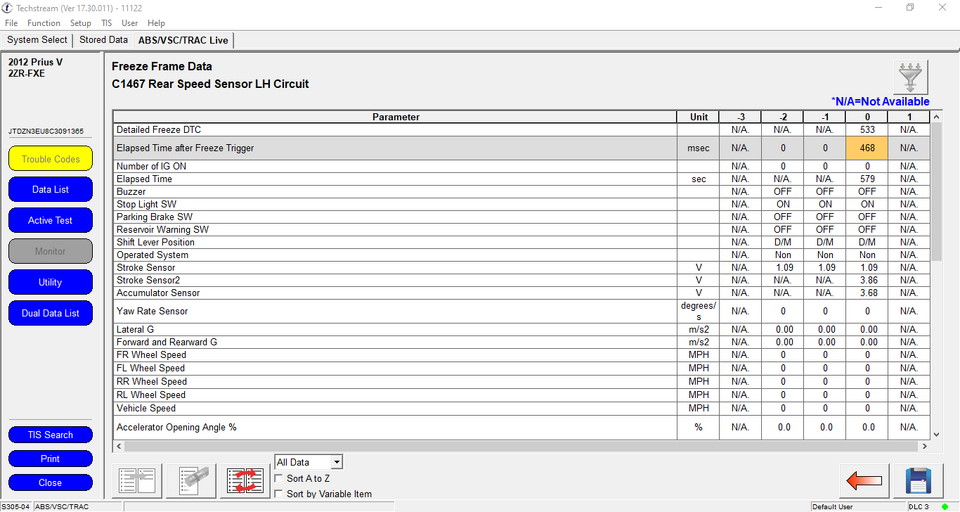

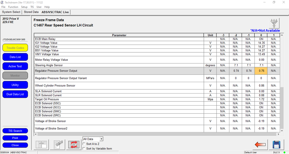

    Hi dear members, my car threw this DTC code C1467, and the ABS brake dashboard light is on.
    Can someone advise me what should I replace or can I test the wiring damaged or replace them... thank you

    Techstream DTC code C1467 numbers

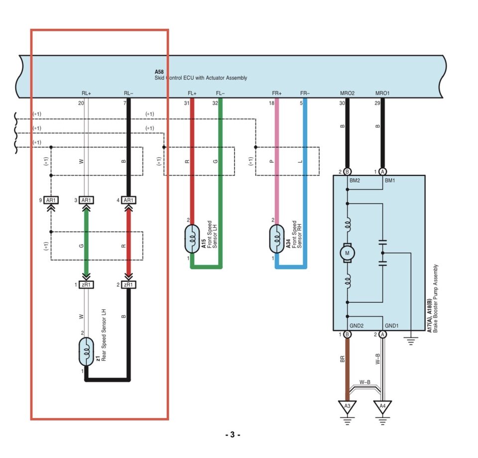

    Did you fix the chewed wires?
    If so, these still might be bad.
    hydtah likes this.
  10. hydtah
    hydtah Junior Member
    May 4, 2023
    usa
    Four Touring
    Thank you so much for the diagram. Not yet, I used electrical tape until I can de-pin the damaged wires :( .

    A person following Toyota's wire repair instructions would not be using solder or butt connectors at all, but crimped, solderless parallel splices, which will not leave the flexible wiring brittle the way solder will.
    The Electrical Wiring Diagram online will supply the part numbers for a "repair wire" (which is the needed terminal already attached to a short length of wire to get beyond the chewed area) and also for the properly-sized solderless parallel crimp.
