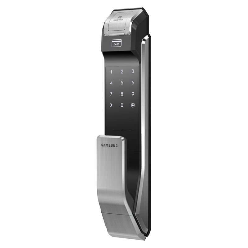

    I'm not buying a car that doesn't have a SKS in today's age. This "they gonna steal my car with a fob hack" is way overblown and crazy. All it takes is somebody with a flat-bed truck and they will steal your car if they want to. The convenience of never having to take a key anywhere trumps the near zero probability of it being stolen because of an SKS spoofer.
    I have even replaced all the locks on all my houses with smart locks so I can open them with fingerprints and passcodes.
    I HATE keys.

    Are the smart locks hard-wired or battery operated? Just curious - what happens when the battery dies? Manual override with buttons?
  20. 2k1Toaster
    Feb 14, 2010
    6,035
    3,856
    Rocky Mountains
    Battery operated. With 12 AA lithium batteries, and 20+ entry/exits a day on average the batteries last about 2 years. At a rental unit with 12 people going in and out multiple times a day it probably had 100-200 cycles a day. Batteries still lasted over a year. For the last 2-3 months of their life, the sound is different as the lock actuator is slower. So you get a huuuuge warning period. Then when the battery is considered dead by the unit, it still works for another few weeks along with an audible alarm after every operation. If you ignore it and it completely dies, there are contactor points on the bottom for a 9V battery. Press against the contact points and it works as normal. There is also an emergency mechanical key, but I don't even know where those are anymore.
    I have actual Samsung Korean door locks, from Korea. All the US and Canadian doors had to modified because door thicknesses and handle protrusions are not the same between Korea and North America. When you're in Korea, every door has one. If you encounter a western style door, it is like spotting a flip phone in the wild. "Yeah, I guess it works, but why?"
    Cleaners have an RFID key that only works on one day of the week. I can use my phone's NFC to unlock the door, my fingerprints, my RFID tag on my keychain with my other vehicle fobs, a manual lengthy passcode, etc. Has a built in alarm, if it detects any of the locking tabs aren't touching metal when it should be (lockpicking) it will forcibly re-lock and sound audible alarms inside and out. If it detects the lock tabs are completely open (like crowbar or kicking down the door) same thing, audible alarm immediately. If you close the door, but it just doesn't make the latch which happens sometimes if you're in a hurry it will quickly make a few beeps to say "hey you didn't close the door".
    I have one like this at one house. I think it looks beautiful compared to a standard door handle and so much more functional:
    RRxing likes this.
