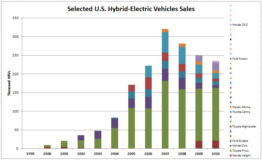

    well, that's just beginning. is suspect battery failures will peak in 2019, there will be a massive shortage, and some 3rd party solutions should be available by then.
