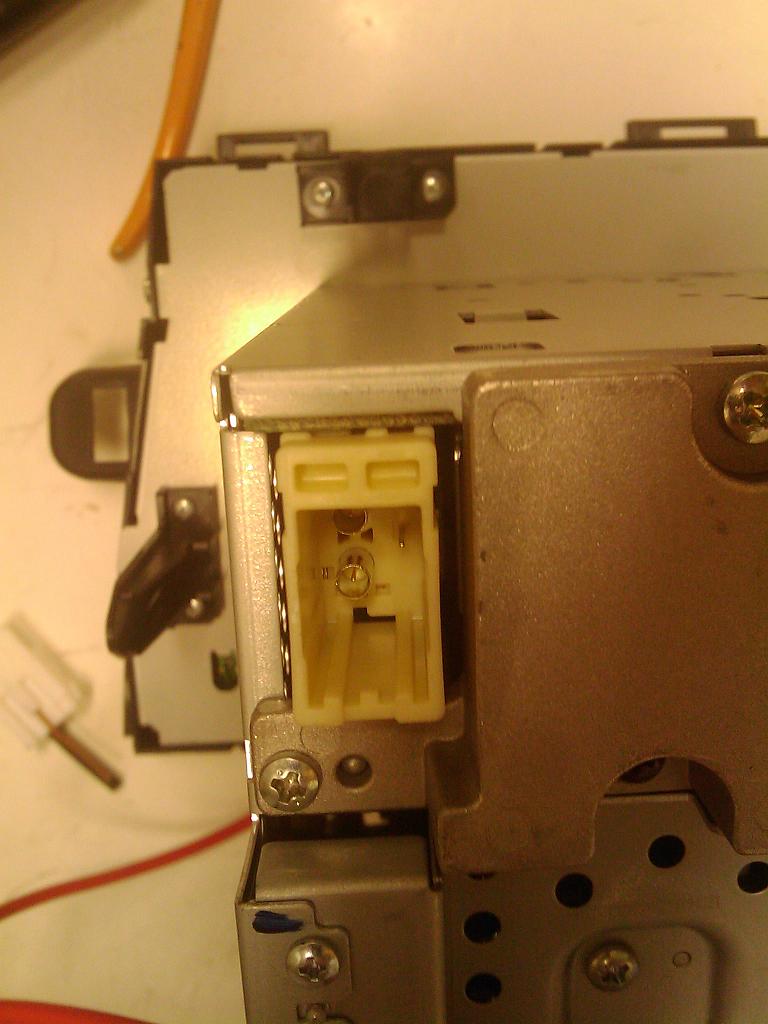

    I've found what I think is the right antenna adapter to allow the European Prius antenna lead to connect to this head unit. Here's a photo, linked from the Connects 2 description of this part, their part number CT27AA78:
    Does this look like the right one, PaJa?
    If so, then it's available on eBay, just search for the part number, CT22AA78
    Jeremy

    Unfortunately their picture is not very clear and it looks to have a different shape which would not fit. I found frenchie's picture:
    I cutted the original wiring and made ant. adapter Toyota-DIN female in case I'll return OEM stereo back to the car. I'll make a photo when I'm back at home next week.
    Here is promised antenna DIY adapter.
