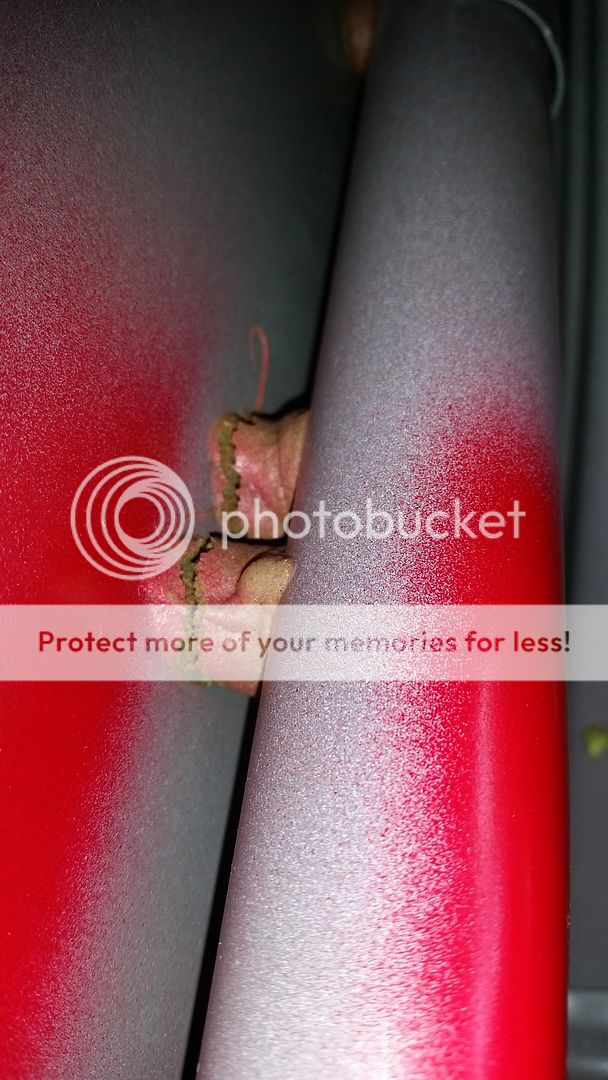

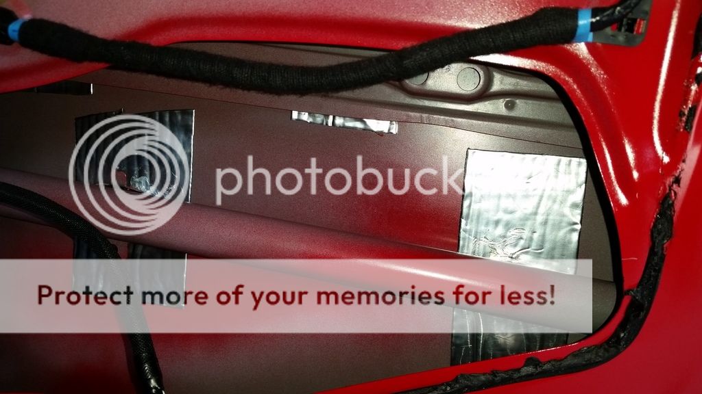

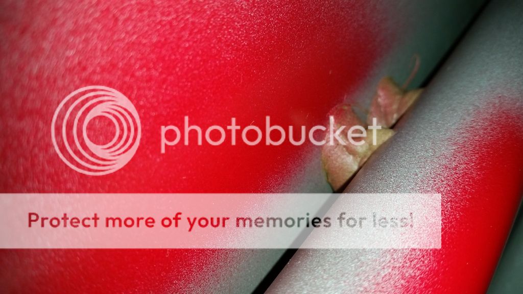

    The sound was coming from a series of broken adhesive connections between the sheet metal of the exterior door panel and the structural support frame of the door. Yes, that is all that connects the sheet metal to the door frame members.
    See the pictures.
    If I had known it was a problem like this while my warranty was still in effect I would have had the dealer fix it.
    However, with the use of sound insulation tape and RTV I was able to tighten the broken connections so that the the door now shuts with a very solid sounding "CLUNK".
    While I was at it, I used a bit of tape between the stampeded sheet metal support above the structural tube. You can see a bit of it in the last photo.
