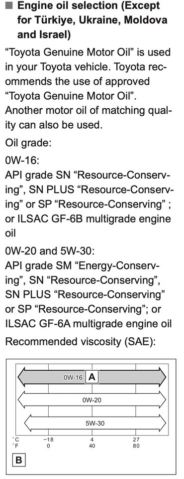

    I call bullshit on Toyota's 0W16 requirement. It's because of US EPA pressure, and probably not the best thing for a long-lasting engine. Same as the 10,000 mile oil change interval. I don't understand why environmentalists think it's better to destroy a car engine prematurely in order to save a small amount of gasoline.
    I found the owner's manual for the 2025 Toyota Corolla, UK edition. It uses the same engine as the 2023+ Prius, the M20A-FSX. Miraculously, you can use 0W30 in England. Here are the screenshots:

    0w16 and 0w8 were developed in Japan. Europe and maybe Japan had longer oil change intervals years before the they came to the US.
    Note the manual has the same note about going back to 0w16 on the next oil change when using a thicker oil as the US manuals do. The 5w30 available in the UK is very likely a synthetic oil, and unlike the US, synthetic oils in Europe use 100% synthetic base oils, and are not a blend.
