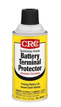

    What I do:
    1) Anytime I buy a new a new car or a new 12v battery, I take a quick turn around the terminals/posts with a battery post cleaner.
    2) I put out a scrap of cardboard and spray the battery with one of the commercial battery protector sprays.
    3) I install battery and forget about it.
    I have been following this procedure for around 20 years and corrosion has never been a problem since I have used this method.
    Prior to using this method, I would have to periodically clean terminals and cases of corrosion, which is always messy and always a pain.
    A quick question though: I did follow this procedure with the replacement 12v I put in the Prius a couple of years ago. But when we got the brand-new car some eight years ago, I did not remove the battery from the car when we originally took delivery nor did I treat the original 12v. It is my understanding that AGM batteries such as in the Prius actually don't have any problems with gunk.
    Is that mostly true?

    Just replaced an 11 year old 12v battery in the Prius. The posts were clean, looked new. I always put a thin coat of Dielectric grease on the posts if I put a new battery in service.

    I would say yes. Since the 12V AGM battery does not contain a substantial amount of liquid acid to leak out of the terminals and cause corrosion, I do not believe there is a particular need to treat the battery terminals. I have not done that with any of the four Prius that I've owned, and the battery terminals have always looked like new when I need to replace a battery.
    For that matter, I haven't worried about treating the terminals on regular 12V batteries for many years. My 2006 HiHy and 2000 Ford Mustang GT convertible both have liquid lead acid batteries and terminal corrosion is not an issue with either car.
