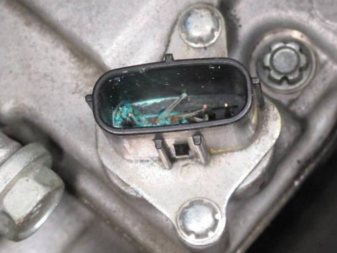

    I'm really reluctant to spray the engine bay. There's one electrical connection in particular, atop the AC compressor, that's really prone to trapping water. And it's nigh impossible to repair if it corrodes out, leading to a very expensive compressor replacement.
    I would take a look at it, try to direct some compressed air at it, if it looks at all wet. The female part of the connection is atop the compressor, like a little cup, with copper electrodes inside. Standing at the front of the engine bay it's at the lower left corner of the engine. The connector is incredibly hard to pull off too, and hard to reach.

    Maybe not so much? A screen-grab from page two of the link I posted:
    This view is looking down. The connector is basically a little cup, and it's impossible to repair, the 12 volt connector to the AC compressor.

    That AC connector seems to be also sealed and seal has leaked. Would be nice to know if there is any changes to that connector in different years, since Toyota has changed some another connectors also(for example one next to fuse box)

  14. Mendel Leisk
    61,421
    42,257
    I have managed to disconnect that once before, was trying gamely the other day, without success. @Ragingfit in his engine swap videos (I should check if there's more uploads) struggles with that connector. He finally get's it off, off-camera, think he resorted to prying with screwdriver.
    Swapping in a Gen 4 Prius' 2ZR Engine into the Prius v | PriusChat
    I forget which part the AC disconnect is in, maybe the struggle commences in one, and in the next he shows the plug disconnected, shows how it's release mechanism works. It's accessable (once you have the air intake off), but just very tight quarters, and takes extraordinary pressure on the tab. I think screw driver, prying, is pretty much the only way.

  16. Mendel Leisk
    61,421
    42,257
    I could not get it come off just now, let it win. I tried levering up on the latch while pulling on it, no soap... :oops:

  19. Mendel Leisk
    61,421
    42,257
    Well I had the air box off today, to replace screw clamps on my oil catch can with kosher hose clamps, and I couldn't resist trying that AC 12 volt connector one more time. I knew it was a typical tab needs to lift at the bottom, to unlock. I'd been trying to pry with a slim flat-blade screwdriver blade, but thinking it was too blunt to get in there, I tried the small blade on my pen knife: it popped off like nobody's business, easy. :)
    Looked like new in there, and it does seem the connector that goes over it would mostly shed water away from it. Still I'd rather not chance it.
    Screen grab from @Ragingfit 's video, there's where you pry. Again, it takes a real thin blade, either a jeweller's screwdriver, a pen knife blade, something like that:
