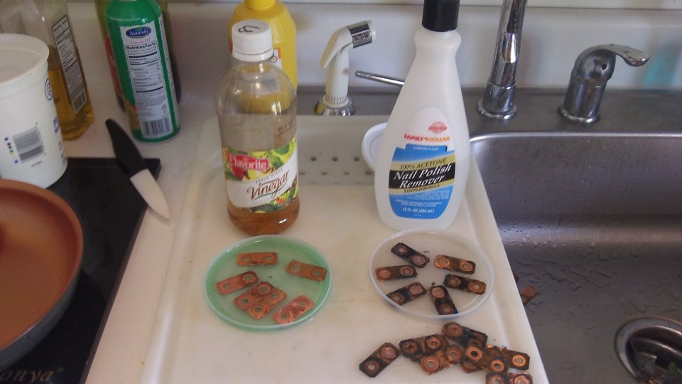

    Bus bars were corroded, and had lots of sealant on them, too.
    I soaked them in fingernail polish remover (acetone) for 5 minutes and the sealant turned to jelly and wiped right off.
    Then soaked in vinegar to clean to bare copper, then rinsed to remove acid.

    Great job! Most people take on stuff like that in the garage, you do it in the kitchen :)

    I found a tip online that worked like magic. Literally, I was freaking out. My bus bar copper terminals were VERY corroded and tarnished. I popped them all out and put them in 3 cups of water, 1 cup of white vinegar, and 1 tbsp of table salt, boiled it for only about 10 minutes, gently shined them up with a brass brush (after rinsing and cooling them with tap water), and they look just like new. Seriously awesome I would highly recommend giving it a try.
