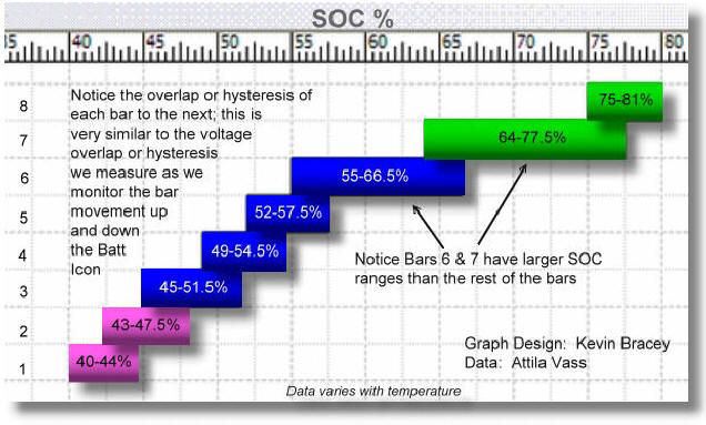

    As stated above the Prius battery SOC normally varies between 40 and 80 percent. Here is a chart that depicts the SOC for the different bars on the display. This was from a Gen 2 post but I think it is still applicable.
