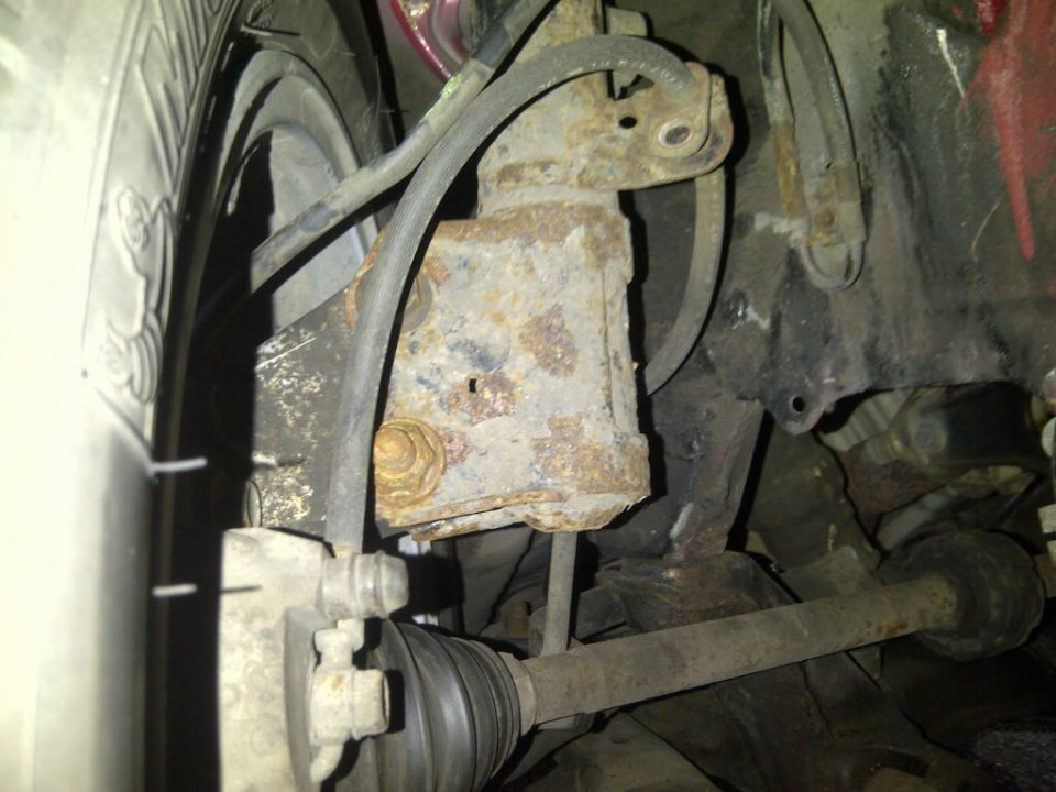

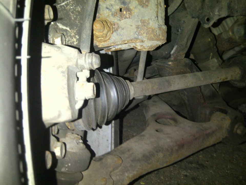

    I did abit of DIY testing...
    when turning the steering left/right - a clicking creeking noise comes out of the right side axle. I can't pinpoint the exact location just from the sound. The same sort of sound comes when you apply the brakes - again, only from the right side.
    whilst i was there - i took photos of that whole area. I found that the rubber boot seemed to be in good condition...
    I have a feeling, based on what I've read across the internet and seen on youtube - it quite possibly could be the CV joint - in which case, there may be a way to strip it all down, and re-furbish it, by flipping the inner core piece back-to-front.
    Would a bad CV joint make creeking noises upon stand-still braking though? What else could it be? I mean, what else would have these symptoms?

    My money is on the CV boot(s) are/is torn, the grease has come out, the dirt and water has gone in and 1 or both outer CV joints are now buggered. Clicking in turns while accelerating and maybe a creaking accelerating and braking in a straight line.

    Adelaide South Australia
    If it sounds like the videos check your disc pad thickness. It might be the brake wear indicators. Could also be strut top bearings or ball joints. Really, without hearing it and getting my hands on it it is so hard to come up with a definitive answer.

    Personally Sam, I'd diagnose something like this hands on. Video only gives the noise not direction or feel. I'd put a hand on the top of the strut while someone turns the steering and a hand on the lower ball joint while turning. Feeling for vibrations. If there is noise from the brakes stationary, I would check caliper slides and that they are lubed. It may be 2 issues, not just 1. It is very easy to check that the disc pad lining is at least 2mm thick top and bottom, inside and out. Wheels off to do a good job. Never get under the car on a jack, always use stands and chock the wheels and not in ready mode.
