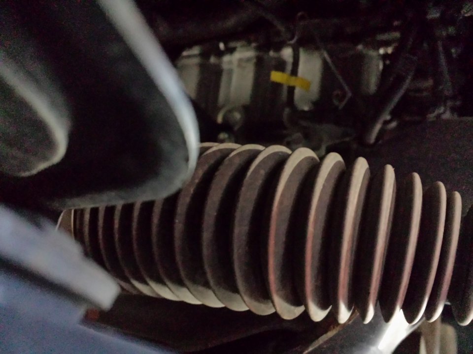

    Is this what I'm looking for? Not sure if the other message sent, but I heard what sounded like a spring over winding, like sproing

    While looking for things, I don't know if it's only been doing it when making turns, I only know I hear it when accelerating from a stop. I'll listen again on the way home.
