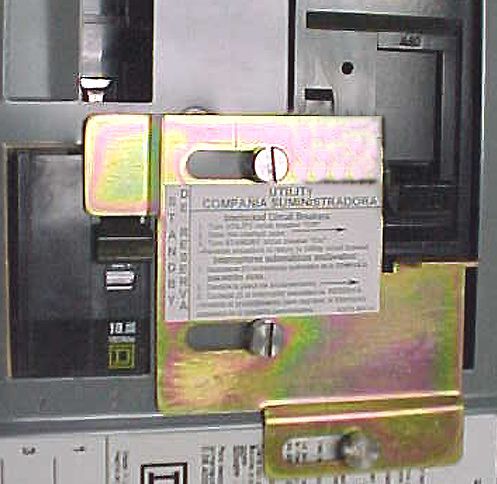

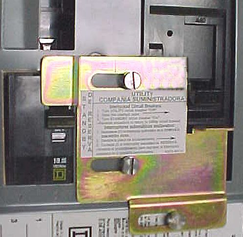

    In many areas, that won't be to code. There's a much better (and equally simple) way to go. Have that 240 line fed into a disconnect box. In the box have 2 individual breakers - one for the heater & one for your EVSE. Have both breakers on an 'interlock' plate (see picture). . Interlock.jpg
    Turning on which position your breaker is in - it's impossible to feed the other breaker. And, each utility has its own breaker.

    Thanks for the advice. The disconnect box looks very nice. what is the brand and model of the box?

    There are several brands ... ours is made by "Square D" - but there are several others.
