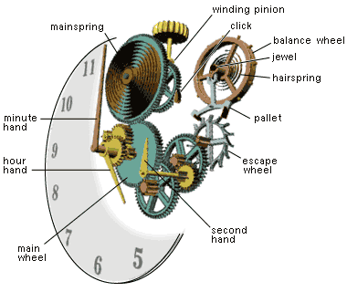

    Other than they are in the same general location, I don't know whether the spiral cable is involved with airbag deployment. OTOH, since they are in the same general location, I would never work on this myself.
    In my other car, I am about to have my fourth spiral cable installed. I participate in a forum for that car also, and I'm the only one that is going through spiral cables every 40,000 miles. Don't know why that is, or why the spiral cable is also called clock spring!

    I believe the Spiral cable is shaped much like the old mechanical clock springs. The airbag gets electrical signals to deploy through the cable.
