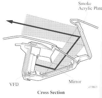

    Don't overlook that the speedometer is a projection; the lens it projects up from is in the bottom surface of the cluster area.
    Have you checked that there isn't just some gunk on that? It's not hard for stuff to end up there.

    What exactly are the surfaces? The bottom flat section is a mirror, so I know to find out how best to clean that. What material is it facing the driver?
  7. ChapmanF
    28,754
    19,060
    It's labeled as a smoke(d) acrylic plate.
    Maybe that is where some of the Armor All ended up, as the warning lights look sort of blurry too, and they shine through it, instead of reflecting on it.

    Discussion of a similar issue here:
    Armor all cleaner product stained the clear plastic covering of gauge cluster..... - NASIOC
    In summary, it might polish off, but more likely the plate will need to be replaced.
    I would suggest getting a mirror and flashlight and closely examining the plate that the light first passes through. It might be contaminated too. If this first plate is OK then putting a small mirror flush up against the second plate should give a clear image. Or at least I think so, never having done the experiment.

    Now I've done that. The first plate (the one that faces up and one needs a mirror--or to look down through the windshield--to see) is the bad one; the second plate (the one the driver looks at) is clear.
    I tried cleaning the first plate again. Simple Green and paper towel did nothing. I then tried Simple Green with a non-scratch pad; it both cleaned the plate somewhat and scratched the plate a bit. I think it's a wash; cleaned the image is a good deal less splotchy, but scratched it's a bit blurred.
    I know I won't be removing the dash myself; maybe next time I take it in to Berkeley's Art's Automotive I'll mention it to them. I doubt I want to spend more than $100 on any work on it; it was OK before and it's OK now. (Couldn't even see the spotchiness except at night...but the slight blurriness does seem noticable during the day.)
