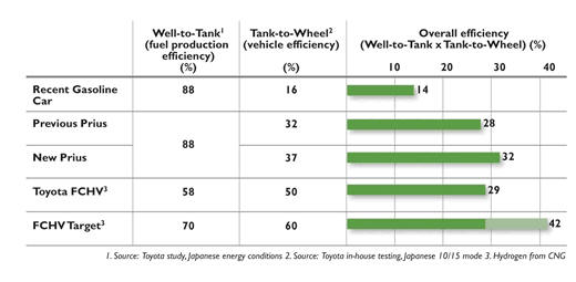

    One car has the powerplant inside, the other outside. Outside does not mean it does not exist, unless you are delusional.
    CAFE fuel economy calculation is the most hilarious of all for EV or so-called alt-fuel vehicles. They realistically calculate a well-to-wheel energy consumption, and then divide the result by SIX. Why 6 ? Just because. And it is politically expedient, a carry-over from Detroit's 'flex-fuel- vehicles and the ethanol circus. To be consistent the same stupidity is applied to EV.
    You want to talk W-t-W ? Fine by me, but you are not going to like the answers (minus political tomfoolery or fanboi delusions.)I'll start the discussion by posting a chart from Wayne Brown, Seminal Prius Hacker Extraordinaire and all around genius and environmentalist:
    His slightly more detailed discussion is here. I guess (and it is only a guess) that Wayne's production figures do not include exploration or extraction, and I doubt they include transport to the refinery. OTOH, coal mining is no picnic. I have read figures that 13-17% of the btu's in the ground make it to the wall socket when all is said and done. I will have to dig up references to substantiate the numbers, and will if you are serious about an informed discussion.
