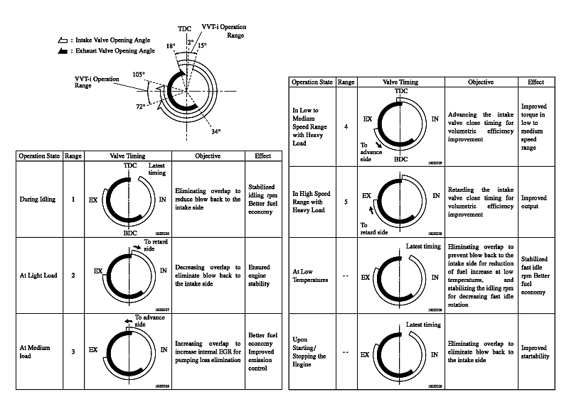

    "engine braking uses the pistons to create drag to slow the car down, useful in the rockies to save brake pad wear."
    I somewhat disagree. The engine braking effort is from pulling a suction with closed intake valves on what would have been a power stroke. The main reason to use engine braking on any long downhill is to keep from overheating the brake pads and fluid. Overheated pads and fluid cause crashes.
  11. White 17
    White 17 Junior Member
    Dec 11, 2016
    59
    17
    Nor Cal
    How does the engine change the valve timing to get the suction against closed intake valves? I know large diesel trucks with Jake Brakes can do this but I didn't know the Prius could. I believe the engine just gets spun with no fuel being injected like most newer cars.
  12. JimboPalmer
    Apr 14, 2009
    12,470
    6,879
    Greenwood MS USA
    It is spun with no fuel and with the valves closer to Otto cycle to hold air captive

    Like many newer cars, the Prius has variable valve timing.

    It doesn't, I believe he described it wrong. The normal power stroke is balanced against the compression stroke, so they are a wash.
    The braking effect is the result of pulling the intake stroke against a strong intake manifold vacuum, caused by a mostly closed throttle valve. The exhaust stroke then pushes against full atmospheric pressure, so this pair of strokes is very asymmetric and don't wash out.
    Valve timing does change to maximize this effect, as shown in Jimbo's graphic. But the valves are never opened or closed in a stroke where they would be the opposite during normal power producing operation.

    (I stole that graphic from Hobbit) If you minimize overlap, you should make the engine do the most work as an air pump, I think.
