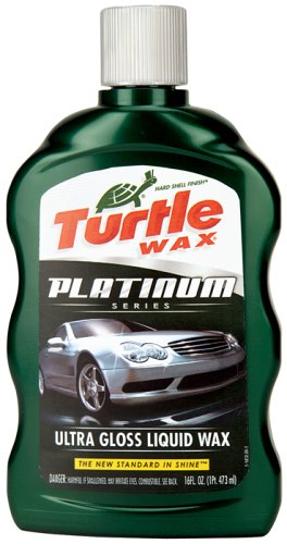

    You're basically describing almost any quality car wax. I like Turtle Platinum liquid, it does pretty much everything you ask for and is a snap to apply. No polishing and it LASTS. Add a second coat and its bullet proof. Don't ever-think this, there's too many snake oil sellers out there telling you that you need this or that. All you need is a quality car polish.

    Being more expensive doesn't make it any better.
    The Turtle Platinum liquid is formulated with flouropolymer resins. It lasts about a year for me. Vehicle garaged and washed about once a month. Like I said, if you want more protection you can apply double coats. Its amazingly easy to apply, no rubbing at all. Suit yourself, but it doesn't take expensive products or special effort to get what you're asking for.

    first you said that im "describing almost any quality car wax", but a wax wont last near as long as i need the protection to last (that pic is a sealant not a wax). then say "All you need is a quality car polish", but polish is for prepping and cleaning the paint surface not protecting it. and follow that up by posting a pic of a Turtle Wax brand sealant... of which is neither a wax or a polish.
    i understand that just because something is more expensive doesnt make it better, but i also believe that if something IS better that its likely going to cost more (usually because its made of better materials). ive used numerous waxes including Turtle Wax and Mothers was by far the best ive used, but im done with waxes at this point. they do not last long enough. i need a sealant or a coating.
    thanks for the recommendation on the Turtle Sealant. you say it lasts you a year eh? and the application requires no rubbing? sounding good. ill look into it.

    *EDIT* my normal edit function isnt working properly
    rdgrimes, my apologies... i was wrong about the pic you posted. i will have to look into that stuff, its wax, but its not carnauba eh?

    Its a blend of polymers and Brazilian carnuba.

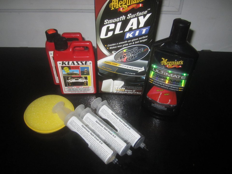

    Hi 2clicker,
    I always being user of KLASSE products over 10 yrs, and only found out about Opti-Coat 2.0 about two yrs ago.
    you can read my comments on this thread, Should I buy $50 Zymol car wax? | PriusChat
