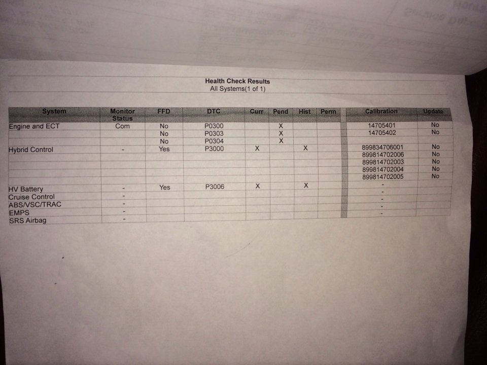

    I purchased and installed a HV battery from Reinvolt last May. My 2002 Prius has been running great, getting great gas mileage, and having no perceptible issues whatsoever. Until Friday. I had driven the car about 3 miles, was stopped at a red light, light turns green, I start to go and the triangle of death sudden shows up on my MFD.
    Took it to the dealer yesterday where they charged me $250 to tell me I need a new HV battery. I've attached the pic of the print out they gave me. Please help me decipher this mumbo-jumbo before I call Reinvolt tomorrow.

    The printout shows that your car's ECUs have logged DTC P3000 and P3006. Both of these indicate that you need a new traction battery.
    Further, you have some engine misfire activity on cylinders 3 and 4, indicated by DTC P0303 and P0304. This means that you need new iridium spark plugs to be installed, especially if this was not done in the last 60K miles.
    If the spark plugs have been recently replaced, look for water moisture that entered the spark plug wells for those two cylinders.

    Not my car, you have a good plan, contacting ReInvolt. However, I would probably wait until the code that specifies the failing module shows up. It would also be helpful to have the lowest and highest voltage pairs.
