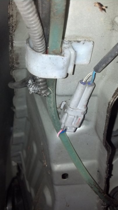

    In the process of re-checking the RH speed sensor, my focus was on the wiring & connector, based on nh70's assertions. Could not find the wiring route inside the engine compartment, so I deduced it was probably mounted to the inner fender. When I pulled down the fender skirt, a small piece of wiring harness fell out, with a chewed-through piece of blue wire inside. Uh-oh.
    The above picture is of the speed sensor connector. Connected to nada.
    I guess a wiring repair is cheaper than a new sensor! Now I hope the little bastards haven't chewed through anything else.

    Folks, am I screwed? Have found upon attempting repair, this sensor wire is not a "normal" wire. It has some sort of shielding around it, and an uninsulated third wire. I also pulled the headlight assembly, hoping to track the wire to another connector, thinking I could replace just the section of bad wiring between connectors. No dice, it routes into a harnass bundle.
    Can anyone familiar with electrical systems in Prius tell me, is this fixable? Or am I looking at having an entire portion of the wiring harnass replaced?

    Third wire is just shield so it doesn’t connect to anything in the sensors end. Since problem is so close to connector and you don’t need to replace long wire you can just repair the two signal wires.

    Thankfully, success!
    Did the best repair I could on the 2 wires, snipped the shielding wire, and buttoned everything back up. First try putting it back into Ready, all the warning lights disappeared. Yay!
