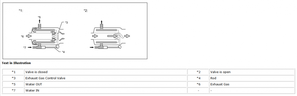

    I've "probably" worked out what item is causing the issues on my car. I haven't come across this issue in this forum before, so bear with me.
    This morning I went under and I sprayed this valve type thing on the exhaust near the second catalytic converter with WD40 and the symptoms lessened.
    When I say the symptoms lessened, it starts the engine a LOT smoother, because, for months now, there is ALWAYS a clunk as the engine kicks in (and shuts down for that matter)... whereas when I bought the car (nearly 3 years ago), when the engine started it was barely noticeable in 'Park', and when on the move if the engine got started to helping the motor move the car or charge the battery it literally unnoticeable other than the extra engine noise and the feel of assisted acceleration. It was silky. Another thing that's pretty much gone is when it's charging at standstill, idling in 'Park'. While driving, it's start the engine and transitions fine, and it does still rattle while on the move, presumably because everything is moving with applied torque and power to the wheels, but it is genuinely much, much better. The real acid test for me now, is when the traction battery drops down to 2 bars in slow moving stop/start traffic because THAT is when it's a real bag of spanners! But I kid you not, the difference is real and I'm not hallucinating!
    So what I'm going to describe below may sound a little misunderstood from my perspective and Prius knowledge, technically illogical but scientific, even controversial and coming across as complete nonsense to some. But bear with me here because it can't be a coincidence, I swear I'm not hallucinating.
    Thinking back to last year, when I cleaned out my EGR system, because of similar symptoms, I also did this same 'quick fix' to the valve in the exhaust and it also worked better again at that time, albeit for a short amount of time, so I didn't think much of the fix and dismissed doing it again because of the ambiguity of whether it actually worked or whether it was a coincidental result, and it's under the car. So the problem at the moment is the ambiguous nature of what this valve thing in the exhaust and how it's the root cause of the symptoms I'm experiencing. But I'll offer my thoughts, and I'll be interested to hear your thoughts, some of you will dismiss it as pure fantasy, other may agree, and others will want to understand more.
    Bear in mind that my Prus is an UK based European spec vehicle. I read somewhere that the exhaust pipes can have different ancillary add-ons depending on the regions of the world the car was sold to.
    I understand that all Priuses have the coolant fluid going down to warm the catalytic converter up to make it more efficient and less polluting? I'm also led to believe it may also work the other way round, whereby the coolant flows to warm the engine up quicker when the catalytic converter get to a hot enough temperature that can help warm the engine? Unless this is what I think this special valve does? Either way, they all have these types of mad features to squeeze as much economy out of the system as a whole.
    I'm sure I read somewhere, that some Priuses (specifically UK ones) have this 'other' thing that has to do with reducing noise levels? This may or may not be part of the same assembly that helps to warm the engine up using hot exhaust gases. As opposed to the EGR system where by exhaust gases are diverted to a cooler to help recycle exhaust (but that's another tangent).
    But this valve thing I'm seeing seems to be some kind of extra baffling that can be introduced in and out of the exhaust flow to control noise levels? Because noise is also loss of energy too! So again, it's an efficiency thing. The whole exhaust 'assembly' add on thing has the coolant pipes coming in and out from up from the front towards the engine. This is where the US cars may be missing a feature, but there's this 'mechanism' where there's a shaft being pushed by a piston attached to a spring loaded hinge that goes up into the exhaust pipe presumably with a flap inside which has the additional muffling to quieten the exhaust noise and therefore save 'energy'. Again, I don't think all Priuses have this other additional thing, but mine seems to have it.
    So if this valve is unable to work to it's full range because it's dirty, dry, corroded, stiff or stuck it would have an effect on the harmonic flow of the exhaust gases thus causing an unbalance in the cylinders as the valves work, therefore leading to what seems like a misfire, but in reality, it's more of a harmonic unbalance in exhaust back pressure, probably not helped by the fact that the engine works more in the Atkinson cycle (presumably controlled by the variable valve system)... Could the above waffle be the root cause of the mechanical unbalance in my engine, which in turn causes the damper plate to vibrate?

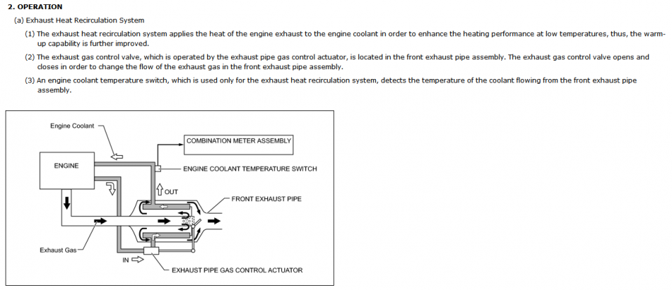

  19. ChapmanF
    28,731
    19,027
    Posts crossed with Brian1954, but I was going to link this old thread instead, which also has these diagrams:
    Does Anyone Know How Exhaust Heat Recovery and Recirculation Works? | PriusChat
    The diagrams, of course, are from the manuals:
    Toyota Service Information and Where To Find It | PriusChat
    Yeah, one of the most important reasons for knowing where to find the manuals, as opposed to just googling around, is that you get the correct understanding on the first try, and don't have to waste time on the wrong ones.
    In this case, it's your second idea, "I'm also led to believe it may also work the other way round, whereby the coolant flows to warm the engine up quicker", that is correct, and wherever you got the idea that the coolant warms the catalyst, that one's backwards. (Also, there's no way the EHRS exchanger could be used to warm the catalytic converter, because it comes after both catalytic converters. EHRS is the third lump in the exhaust: 1st cat, 2nd cat, EHRS, resonator.)
    The movable valve, as you can see in the diagram, is not there for noise, but for temperature regulation. When it opens, exhaust flows straight through, without having to pass through the heat exchanger. During warmup, the valve is closed, and the exhaust has to take that longer path through the heat exchanger and heat up the coolant.
    The "actuator" is a simple pellet of expanding wax, just like an engine thermostat; as the coolant comes up to temperature, it expands, pushes that rod, and opens the valve so the exhaust can flow straight through.
    The valve is supposed to be easy enough to move that higher exhaust pressure can flap it open even during warmup when it's normally closed; that way, it doesn't interfere with hard acceleration if you need to do that while the engine's still cold.
    Again, all that information on what the system's for and how it works is right in the manuals; armchair speculating about it is the slow way to learn how it works. The old thread title "Does Anyone Know How Exhaust Heat Recovery and Recirculation Works?" has the easy answer "yes", since the only way to not know is to not look it up. :)
    You could certainly maybe have a backpressure problem during warmup if the flap doesn't move as easily as it should under exhaust pressure. On the other hand, it's pretty certain to get opened once the coolant is hot, because an expanding wax actuator pushes really really hard.

    I did buy a two hour subsrciption to Toyota TIS this afternoon and did see those pages. So your quite right to call me an armchair speculator.
    So now I know it, and what it does. I'm going to spray the mechanism again in the morning, might pop the spring off and lube the shaft the flap is on, and make sure it moves freely. It might be a bit crudy to move, or the spring has rusted up a bit on the inner turns it's coils. I'll also run the engine and watch for the shaft coming out, and how hard it pushes. I'm not disputing you saying it pushes hard. Could the thing fail in some way? Could the wax leak or age or harden or soften? I assume I could verify if the water actually gets to it by feeling the water pipes? Maybe it's time to change the fluid? Crud might have collected and settled down there? Anyway, I'll post back again tomorrow when I've been back under it.
