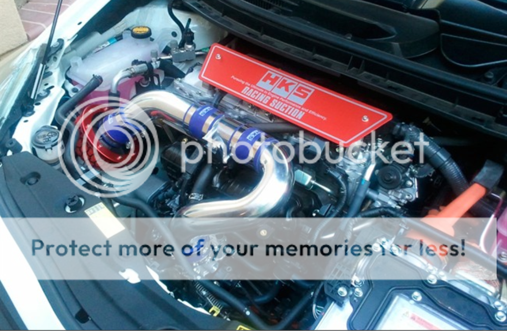

  18. edthefox5
    edthefox5 Senior Member
    Jul 25, 2007
    10,096
    4,840
    Clearwater, Florida
    Wow what is that JDM?

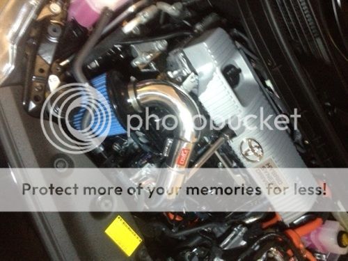

  19. tf4624
    tf4624 Active Member
    Dec 4, 2009
    527
    51
