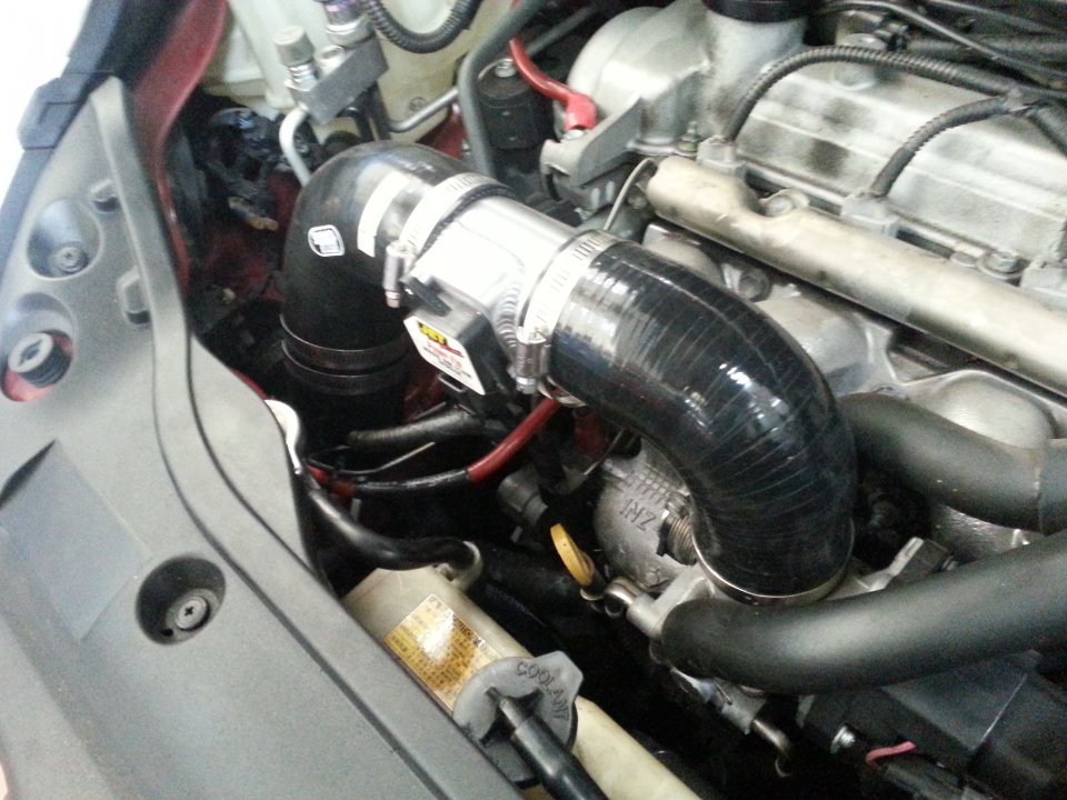

    Finally had mine installed with 2" MAF Housing and with an open pod Apexi Filter. Initial move especially up slope i will received Code P0171. Damn.. may be I need to reset via pulling out 12v Battery.
    Over all, Great response, Mean Sound when full rev and RPM and speed climb a lot FASTER!

    Update.
    Stock box, outside temp 34c, scan ii read lowest 38c
    CAI intake, outside temp 34c, scan ii read lowest 34c!
    Both reading was done with coolant by-pass throttle body.
    Reading based on highway! Amazing as here is summer hot and humid.
    Just reset code via scan II and reset via battery too.
    No CEL for 6hr drive

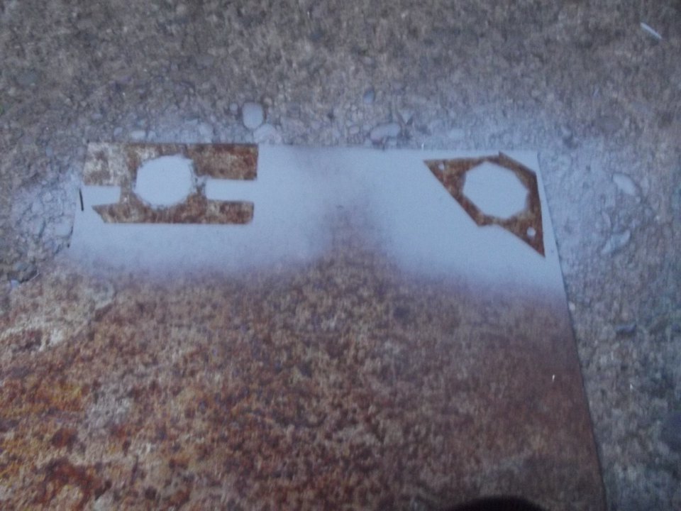

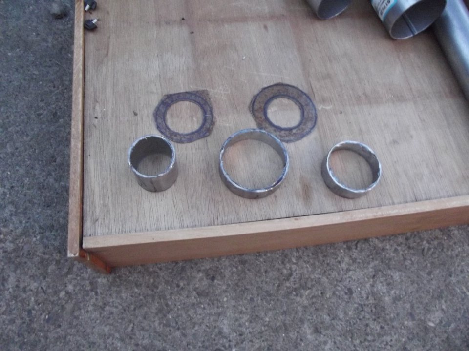

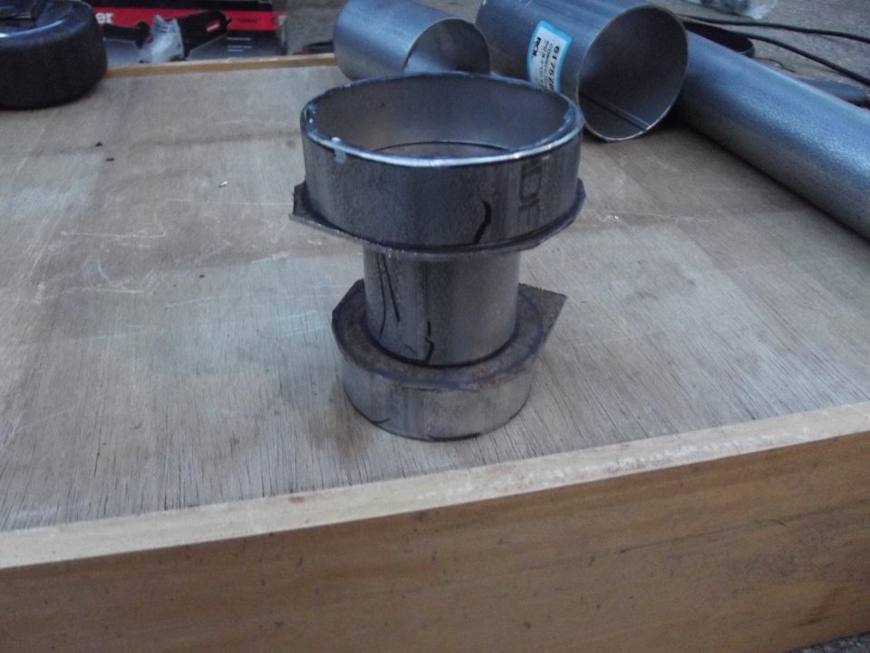

    so I decided to give this a go myself, bit of a different take figured I'd experiment a bit with some cheap steel and fab my own airflow meter to factory spec,
    For what is worth you 2 boys running the 2 inch meter it's still too big, the factory one is more like 1 3/4, the sensor mesures the air that goes throu it alone and multiplies it by known diameter, you are not accounting for the air in the extra 1/4 inch diameter, running lean thou close to tolerance limit, the lamda sees it and the ECM compensates but every now and than you get a code.
    I have taken some pics, I am trying to keep all the specs as close to stock, besides the meter you can go with any size you want but this one maters. nevermid the rough edges I shall be stiching this up soon there will be some grinding later, right now I can actually use the extra metal to handle tha parts
