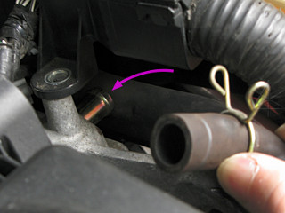

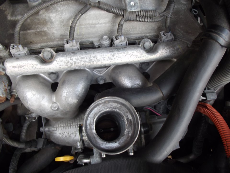

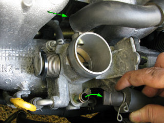

    figured your googleing skills would come in handy, now what about the little one in the back of the tb, looks like a vacum and goes to a sensor, does this engine employ a map sensor too? I thought it would be one or the other, heard of setups with both never seen one before, I'll tell you where I am going with this, in my other project I have to drill a nozzle for 2 map signals, if that what this is might just tap into it, got more pics, I just finished putting a couple coats of grill paint on it, I may paint it blue on top of that but it will probably flake off if it gets too hot
    one last thing what is the storry with those fancy maf sensors you boys are running? thought I blew mine in the process turns out just got dirty, but I might as well look into it.
    I also ordered this : kindof girly, 3" Universal High Performance JDM Mushroom Cold Air Intake Short Mesh RAM Filter | eBay
    the narow ones I did not get, I may but from what I seen they are 6 inches tall, I was looking at mine today, held it in hand, and it's not that big just everything else under that hood is that small makes it look huge, looks like the elements are fitted to the flange and top with some sort of hotglue, anybody know anything about that? wonder if I could shorten it a couple inches, still waiting on the ebay stuff to come in

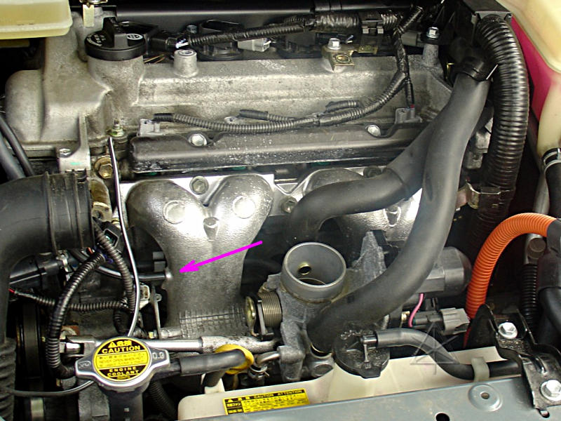

    According to TB cleaning the yellow arrow is pointing to the hose that connects to the vacuum switching valve.. part of the EVAP system.
    As far as I'm aware the Gen1 still had a MAP sensor - the Gen2 has pretty much the same thing built into the MAF sensor.
    From what I've seen of other LPG installs (haven'ts seen many) I've seen the manifold tapped right behind the TB for most likely the 2 MAP signals your wanting.
    Might be able to tap into the HCAC

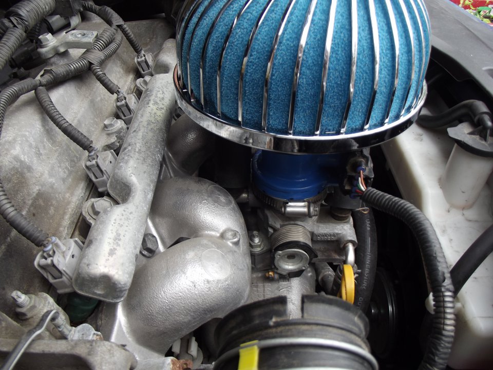

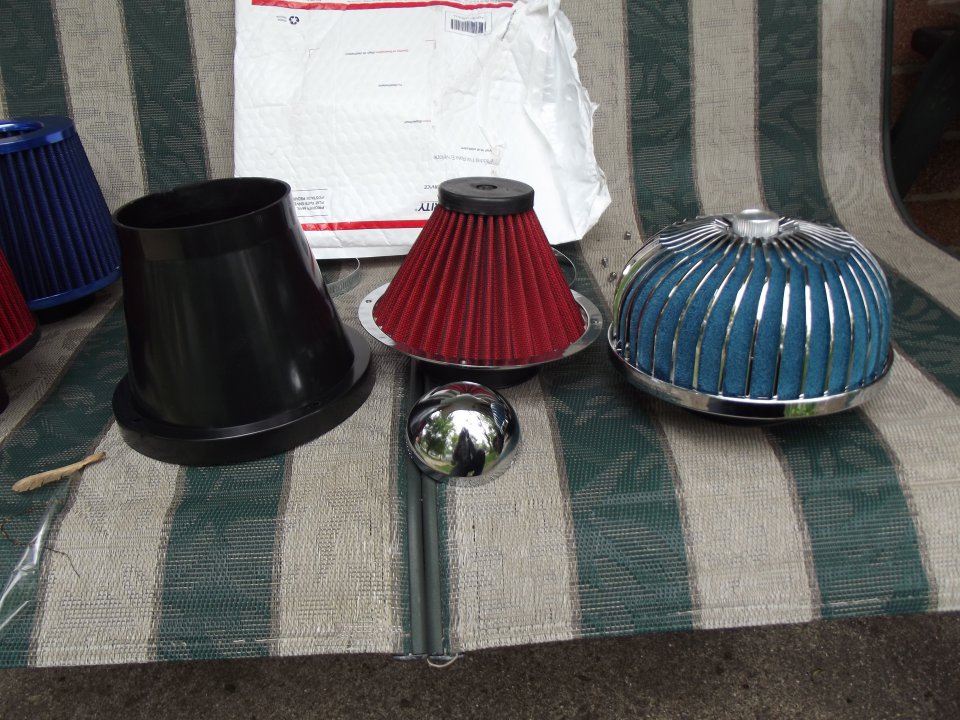

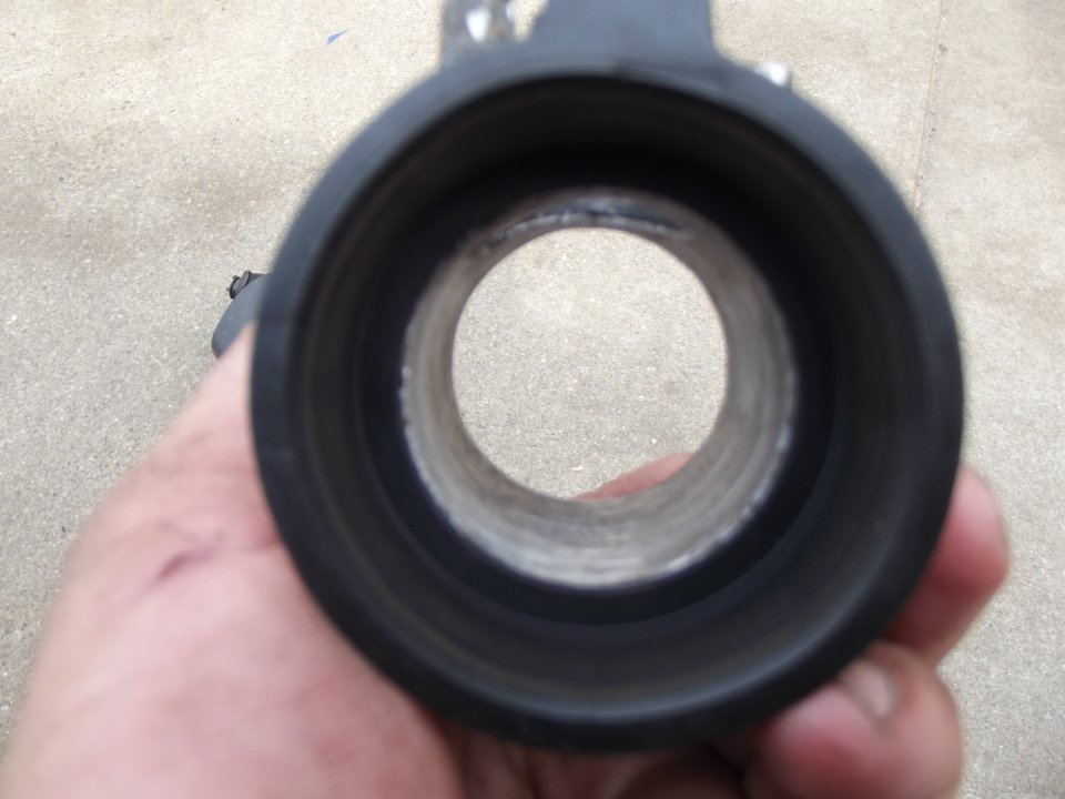

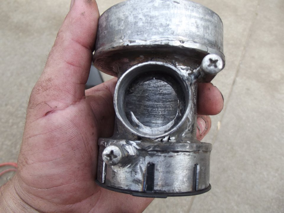

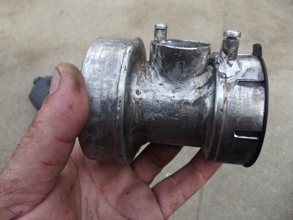

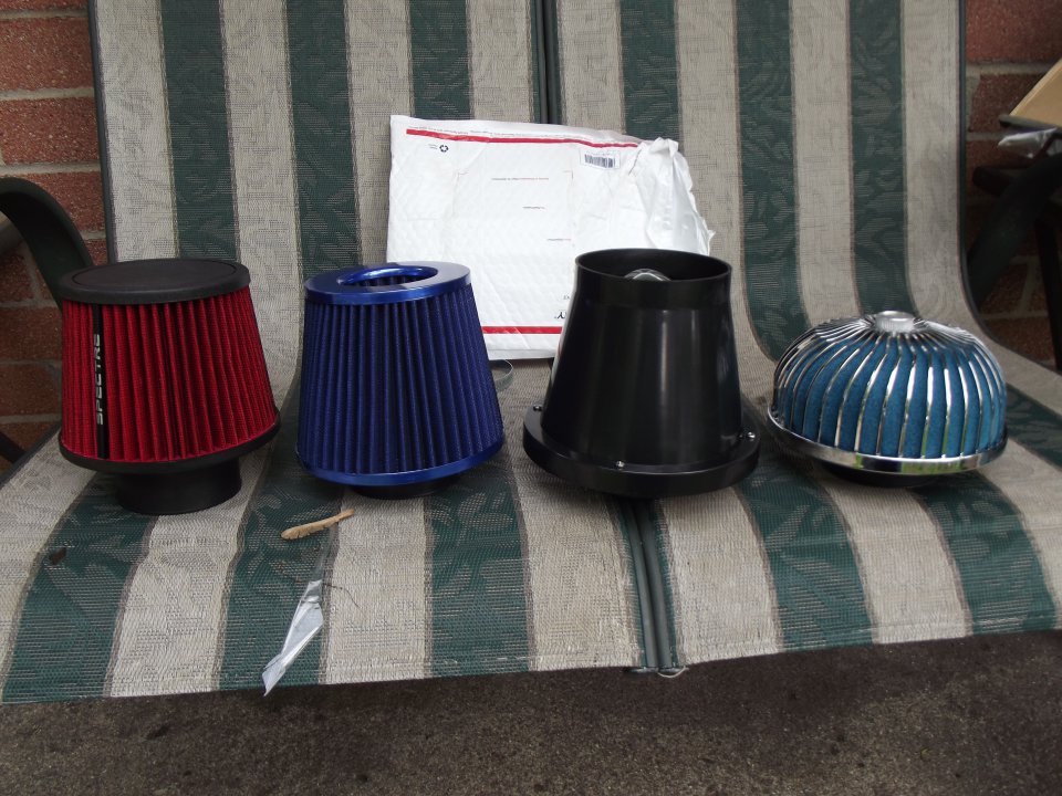

    well boys and girls I have an upate for you, more pics and some findings.
    My Fleabay filters were all delivered today and I could not get off work fast enough.
    DSCF4499.JPG there's a pic side by side, now you may not notice in the pics but for $9.25 delivered they are all assembly line rejects, exept for the foam one that's just a bad Ideea put together well, they are all good filters otherwise, but $5 was likely shipping from cali to michigan, most of the rest shipping from china to cali. they all have a metal base and a snapon rubber boot, the blue one the short ram typesimmilar size as the $20 spectre, shorter boot still too tall can't use it just yet, if you notice in the pic it's also a bit crooked, and that is at a good angle, that's why it got kicked off the assembly line, a good filter otherwise and I would not hesitate using it just not much I can do with it on this project.
    the black one, well that is actualy pretty cool

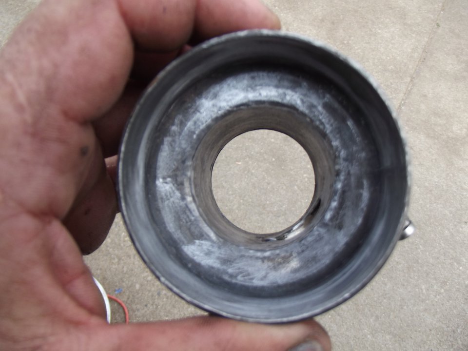

    DSCF4501.JPG it'a defect the round chrome cap was screwed on crooked ( don't care, probl wont use it ) and the base is real loose on the snap boot, not sure if it was ment to be this way, likely a defect too. bit taller than the foam one just about as wide as all of them 6" about the perfect cross between the motorcycle Ideea and a full size 3" I think this one is my best bet.
    now the blue foam, well made thou like I said bad Ideea, I think the add said stainless, go figure shiny plastic, can't say I did not see it comming but the whole Idea abut buying these filters was that they are cheap to experiment with ,there are better ones, and the holy grail HKS, this is a cool ornament at best, and it was the first one I tried, since it had the lowest profile I could easily close the hood on top of. I'm not even going to coment on filtering capabilities, likely crap, but again these are just to get a feel for size.

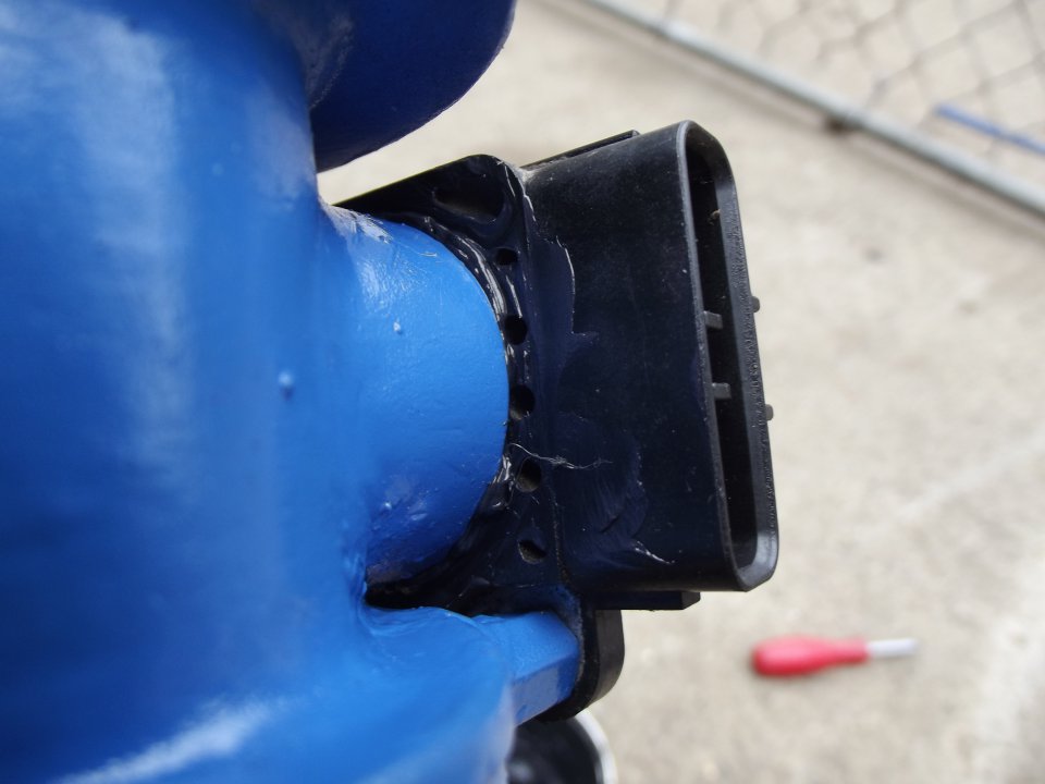

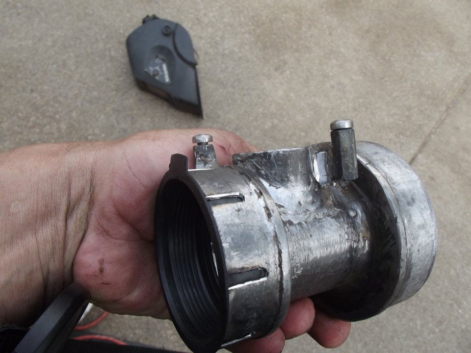

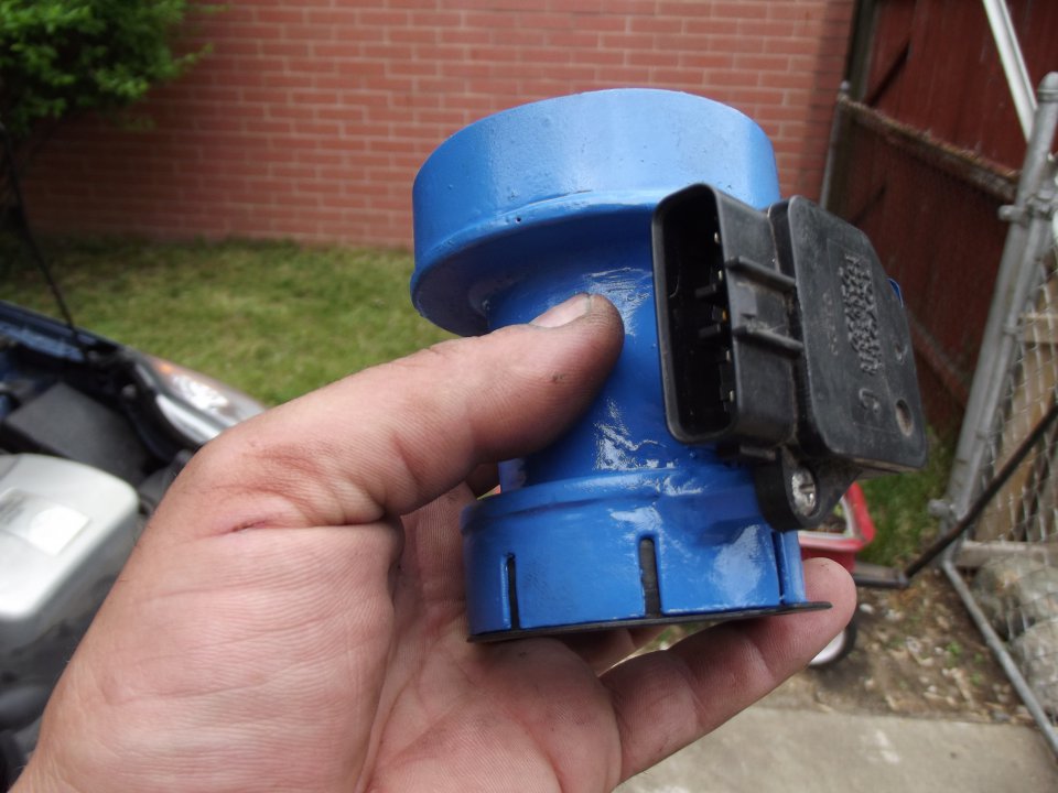

    here is my sortof finished custom handmade air meter built to factory specs to the best of my driveways capabilities, I'm sure I am off a fraction here and there, a lathe or cnc could do better (if any of you have access to such equipment I'd be interested to find out what can be done), but I don't have one laying arround in the garage, never used Cad to design parts either, I was born with such built in.
    DSCF4502.JPG one thing I noticed, food for thought for you boys running the aftermarket cnc mount, there are a few holes at the bottom of the sensor, they may be breathers, for the sensor does not overheat, from what I could see in your pics you are covering them, not sure how good of an Ideea that is, works for now I guess, also much larger contact surface, aluminum is a dam good heat sump too, chack and see how hot that pipe gets after a good drive
    SFO likes this.

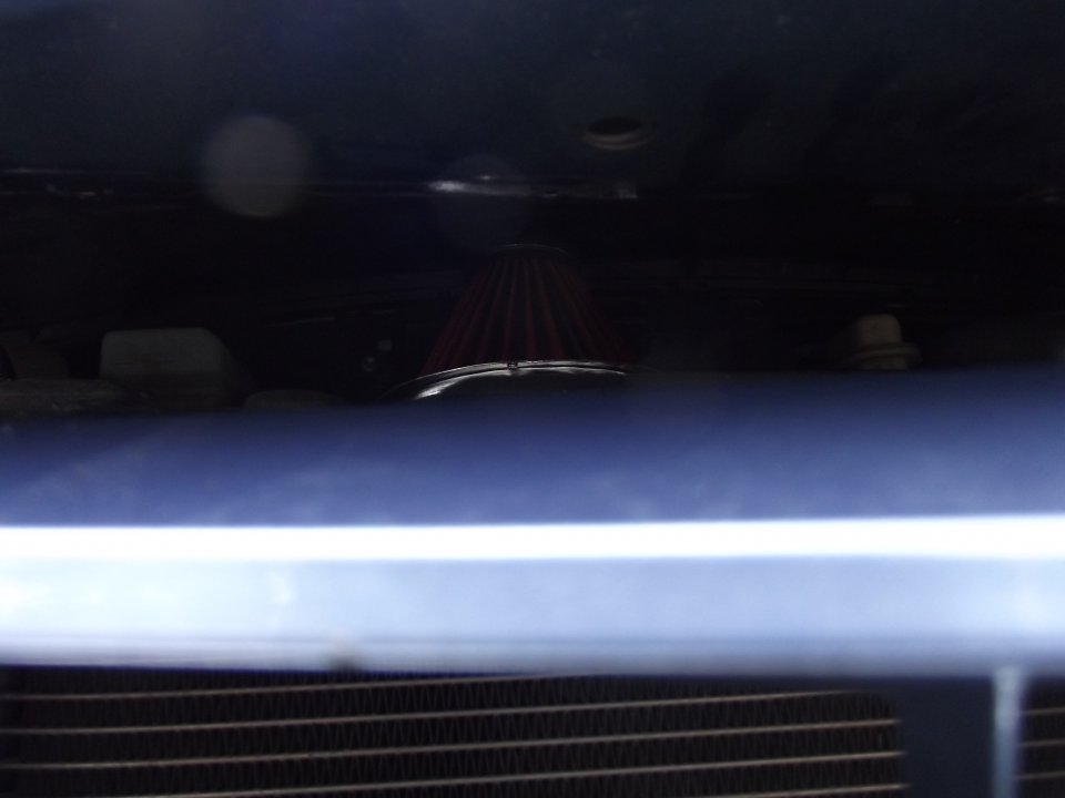

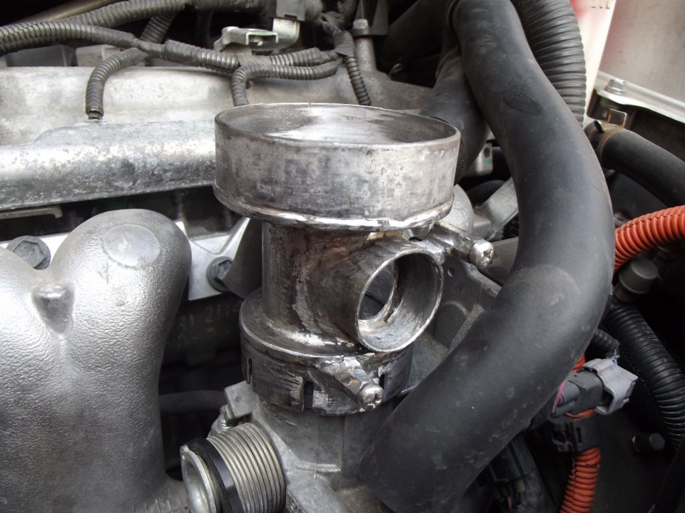

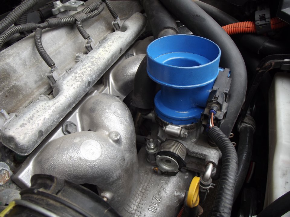

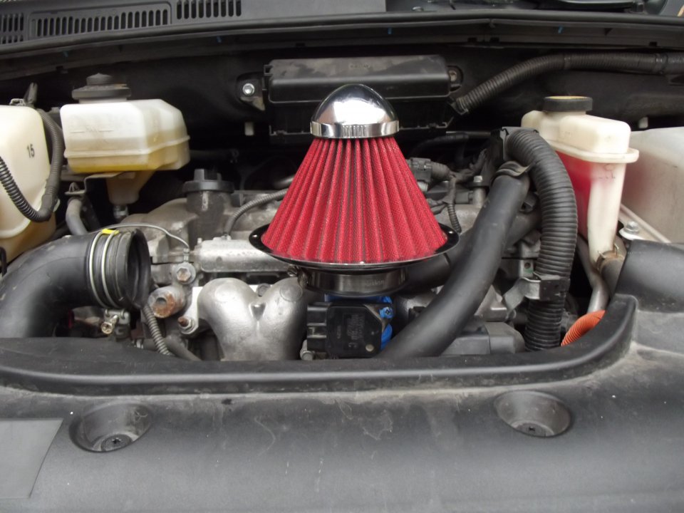

    DSCF4504.JPG figured I'd break this up, lost a good mesage earlier. here it is mounted, dont look bad at all from a couple feet away
    and here's a shot with the girly plastic filter on, notice the focus here is to showcase all the room I have now ( reason I tackled this in the first place)

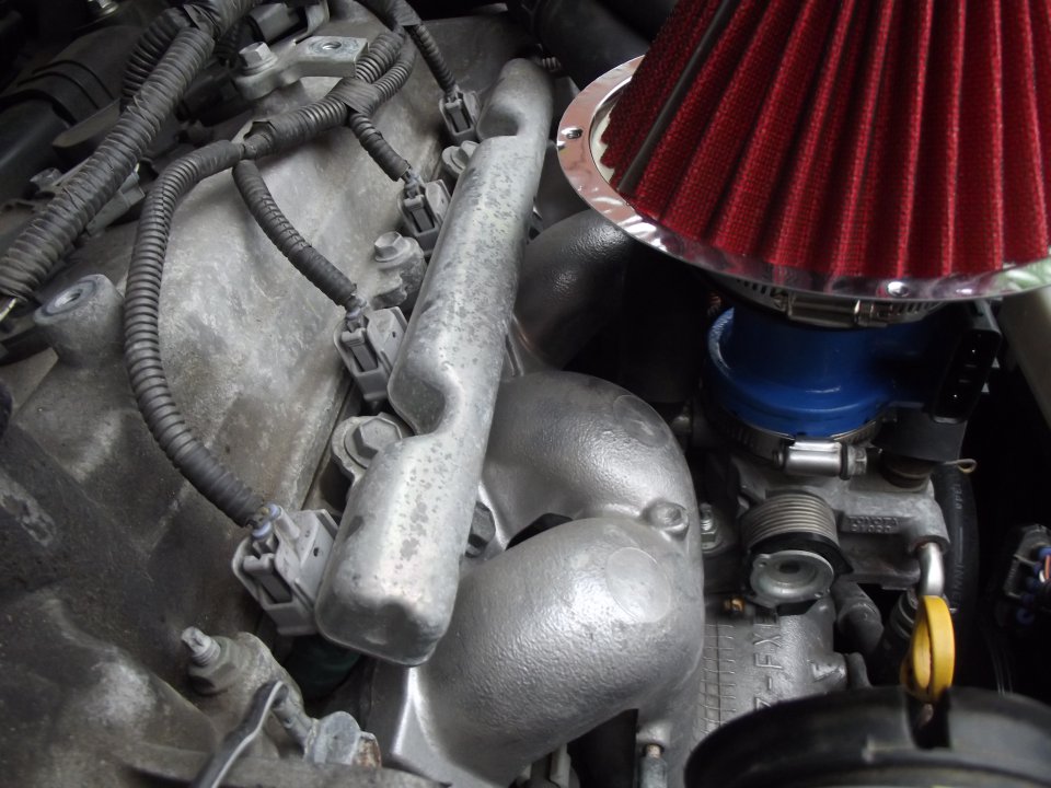

    now I removed the rubber strip on the hood to alow some air to sneak up under and we went for a drive, returned the red $20 filter, and a piece of conduit, I could not use, some mixed city drving and a few freeway miles at 55, just to make sure it works up to operating temps, only about 15 miles but so far no codes, I'd hate to jinx it but I think that is where the exact meter diameter comes into play, could not tell you more till further testing, not sure what was going on on the setup without the permanent filter, the different media? who knows, my vacum exhaust carbon activated 3" pads are not here yet.
    Now I never drove this car so there was no sense me testdriving it, the wife did all that, here's what I can tell you for a fact you draw your own conclusions, I just realized I should have had my scaner pluged in, I'll check it tomorow, with our routine lately we have been getting a pretty solid, 47.5 mpg, 10 mile drive one way, most stores are within a mile, you could tell when the wife went shopping just by the crapy mpg from all these 1 mile trips. Since this project started we've been running arround town to find just the right pipe, logged a few more miles than usual on one warm up, before this setup there were 48.6mpg showing over aprox 220 miles since reset, at the end of the test it showed 48.7 over 235 miles since last reset, as long if it doesn't do something stupid like 44 I'm ok with it, if it keeps going up I am even more confortable.
    now there is a simple explination for all this if you care to know, the wife is not very mechanical, I don't think she understands what those filters do, thow we know eachother since we were kids, even than she did ask is this supposed to change the performance? I said sure, how bad is it? just slightly not enough to write home about wasn't sure I should say something, I asked her how it compares to the new C she testdrove last fall, again she says: I almoast wanted to mention that it drives almoast like a C, that was her complain with the C felt lazy, likely the underpowered electric setup rather than the gas motor in that case but she would not know better.
    Now here's my take on it so far: The air meter is working just fine, I did not notice this before, never paid atention, those of you that believe the prius has a stock warm air setup keep telling yourself that, who knows it might become true one day, truth be told the stock intake is no warmer than the best K&N cold air intake setup regardless of what make and model DSCF4513.JPG car we are talking about. Have a close look at this pic

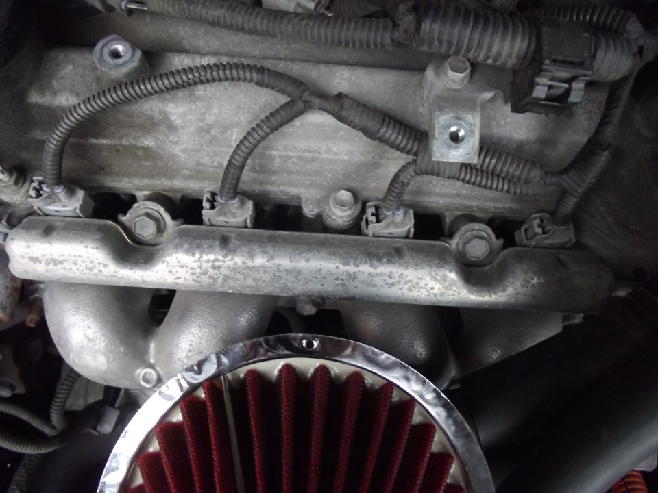

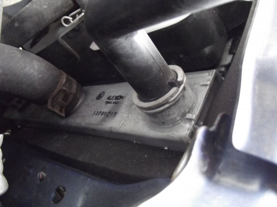

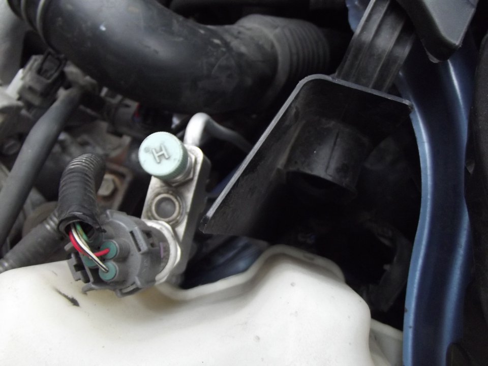

    I have a bit of an update and I could also use a bit of input to move further,
    We logged a few more miles today on the red cone, that silver cap deffinately touches the hood insulation as there is a dent in it, but it wont be there much longer, now this one is a real filter and I do believe it's just the right size, logged 10 miles at 8 am to work, a short chore at about noon and 10 more home just now, I checked the filter and my meter and they are cool to the touch thou the intake and TB is pretty hot, my trusted testdriver indicated a clear lack of power, not enough to write home about deffinately much better than the blue ornament, not as good as stock but just bearly enough to notice, I had a look at the plastic cover over the rad bracket, and it apeared to raise the profile about 1 inch so off it went DSCF4518.JPG now there's 3 things in the way that I would love to do away with, at least the rad reservoir cap I would love to lower an inch or so, to where the vent hose is just below the rad brace, I can cut that tube down, no big deal just have to figure out how to fit a new cap and vent on it, I am not familiar with imports maybe a different model has a tank that would suit me better?
    the rad fill cap same thing, but that is a high pressure high temp piece of plastic, no joke there, now have a look at this pic
    DSCF4517.JPG now that looks like an oring fitted with a clip, I wonder if a corola or something might have something shorter, Justdidit this is where your crossrefrence skills come in, I could use some help here, there is also a bracket for an AC line bolted there, but that's metal I gor that one I took a picture with the hood poped you can see the filter through, tried it with the hood down too but the pic don't show much
    now I could work arround all that or just leave it as is, it ought to be pretty close to stock by now, but I am not one to leave well enough alone, I will hit the junkyards see what can I work with but this is michigan not known for an abundance of imports. DSCF4515.JPG oh and as for the mpg display it went up another point it is now at 48.9, now mind you before all this running arround our daily routine yelded a pretty solid 47.5, at the time of the experiments started with 220 miles on the clock at 48.6, I know exactly why that is and it makes perfect sense, it's in no way more efficient, so don't get the wrong Ideea, but it deffinately gets better gas mileage, and you can duplicate the same result by lightening the right foot.
    any input, leads would be apreciated I'm off to ebay for Ideeas

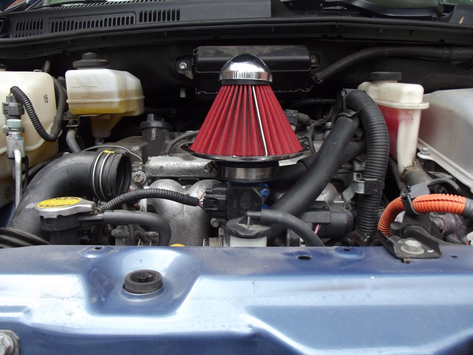

    I have a bit of an update too, meant to write it up last night but passed out, bought some cheap cardboard at dollar store couple days ago and last night had a chance to play with it and mock up a ram box which I intent to mount under the hood, took some pics but did not get to upload them, in the mean time I am running the plain filter warm air just like you all last saw it and the new tank yielded an even 50mpg, never had that before, granted weather got a little warmer and that may have something to do with it and my trusty test driver can't tell the difference any more just the intake noise.
    my 3 " carbon filters were delivered too, took a while but I shall experiment with them shortly,
    I cut down the expansion tank neck and it is below the upper rad support now, also shortened the rad blow nipple to free up some room and done away with the bracket for the ac line ( that I may built a different one and bolt it under the rad support)
    no cel yet, and I do not expect one anytime soon nor would it be welcomed, still have no clue why the setup with the stock box no carbon throws it, I went the extra mile to make sure I duplicate the stock meter as close as handmade can get, if anything in the process I got the maf sensor dirty and it threw a similar code, couple squirts of cleaner took care of that, and it has not complained since, wonder if when you swapped boxes you also swapped sensors, I am starting to think the carbon filter is not the one triggering the code.
