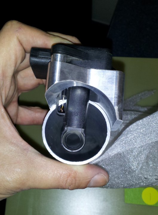

    my custom intake was built mostly to make some room under the hood, I went out of my way to match the stock air meter, so that it won't perform any different, either way any mod will vary your performance to a degree, notice how I said vary not increase.
    first filter I tried, an hks knockoff, actually lowered power output, granted it was just on top of the airmeter, no CAI, but it was a bit restrictive I guess, no codes, less power and a bit better economy.
    the second filter, a reusable cotton mesh, k&n type performed rather similar to the stock setup, again, no CAI,
    my final setup, with the shield built around the filter, it wasn't just a CAI but also a bit of a Ram intake as it drew air in from below the hood lip. that worked real good, again no codes,
    the key to it, I believe was the air meter, there is no commercially available, 1 3/4 inch I believe it was, regardless of the setup before that, weather it is restricted, cold or warm, it doesn't matter as long as the computer can get an accurate reading, it will make proper adjustments, performance will be reflected as well but all in all it will be no different than running at sea level on 90F weather versus, up at 12000 ft at -40F or anywhere in between,
    When you go and put a 3" meter with the stock MAF, than you are asking for trouble, besides it's pointless, the intake will be restricted by the smallest component, the TB mostly, so there is no point at all to go any larger than the TB at WOT, you can get a smoother run if anything, the stock intake is a CAI anyhow, may be a bit restrictive for noise purposes, honestly I don't mind intake noise, I prefer simple over introcate restrictive silencers.
    as for dino tests, reflashing ecus, and all that is quack as far as I am concern, it's a prius for crying out loud, what else can I say

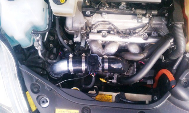

    intake is on the front of the ice, and there's no room above the hot ex manifold for a filter. nope. under and behind the rh headlight is the best place, and unless you drive through a creek, your not gonna suck any water. i've had mine there for many miles, no problems.

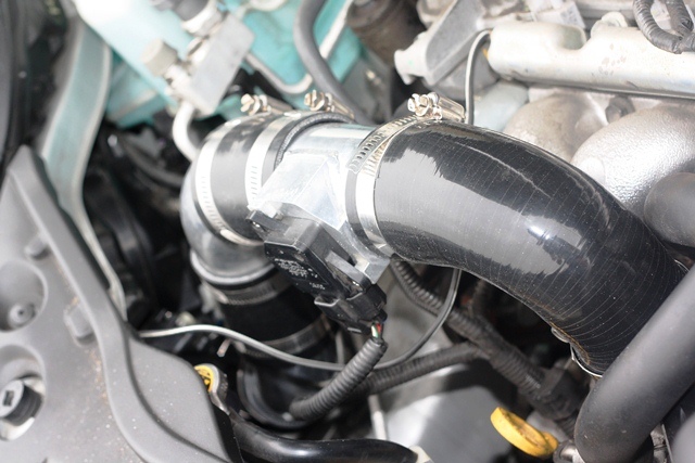

    This setup worked fine for me - routed below the passenger headlight.
    Rotated the MAF housing to see if it made a difference - none. Worked great either way as long as you stay with a 2" MAF housing.

    but where can we get a 2" housing inexpensively? i would ditch the airbox if i could.

    As for as more MAF housing, I had mine custom made. I know the guy I had make mine would make more but only if he was making a batch of them. The piece I had custom made was only the part that holds the MAF sensor, it still needed to be welded on to a 2" tubing.
