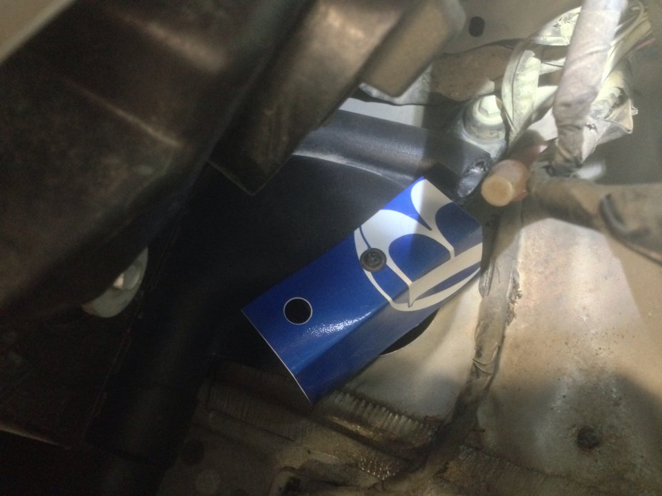

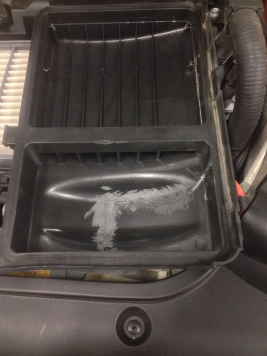

    Here's my filter set-up.
    Top of the air box.
    The air inlet. The blue thing is sealing the end I cut off with epoxy and one of the screws from the pipe. This is just temporary as I will be making a hose to replace it and possibly to replace the air box as well.
    You can't see in the 2nd picture really well, but the baffle is gone.
