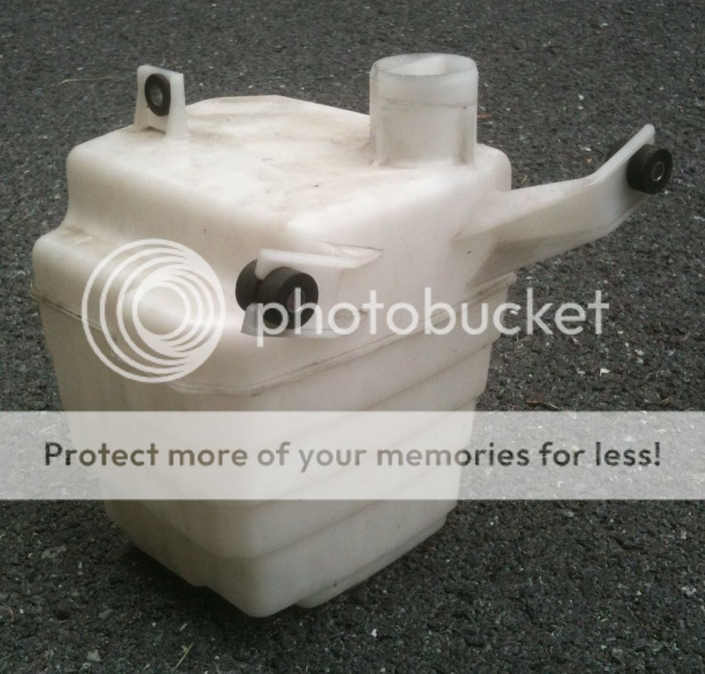

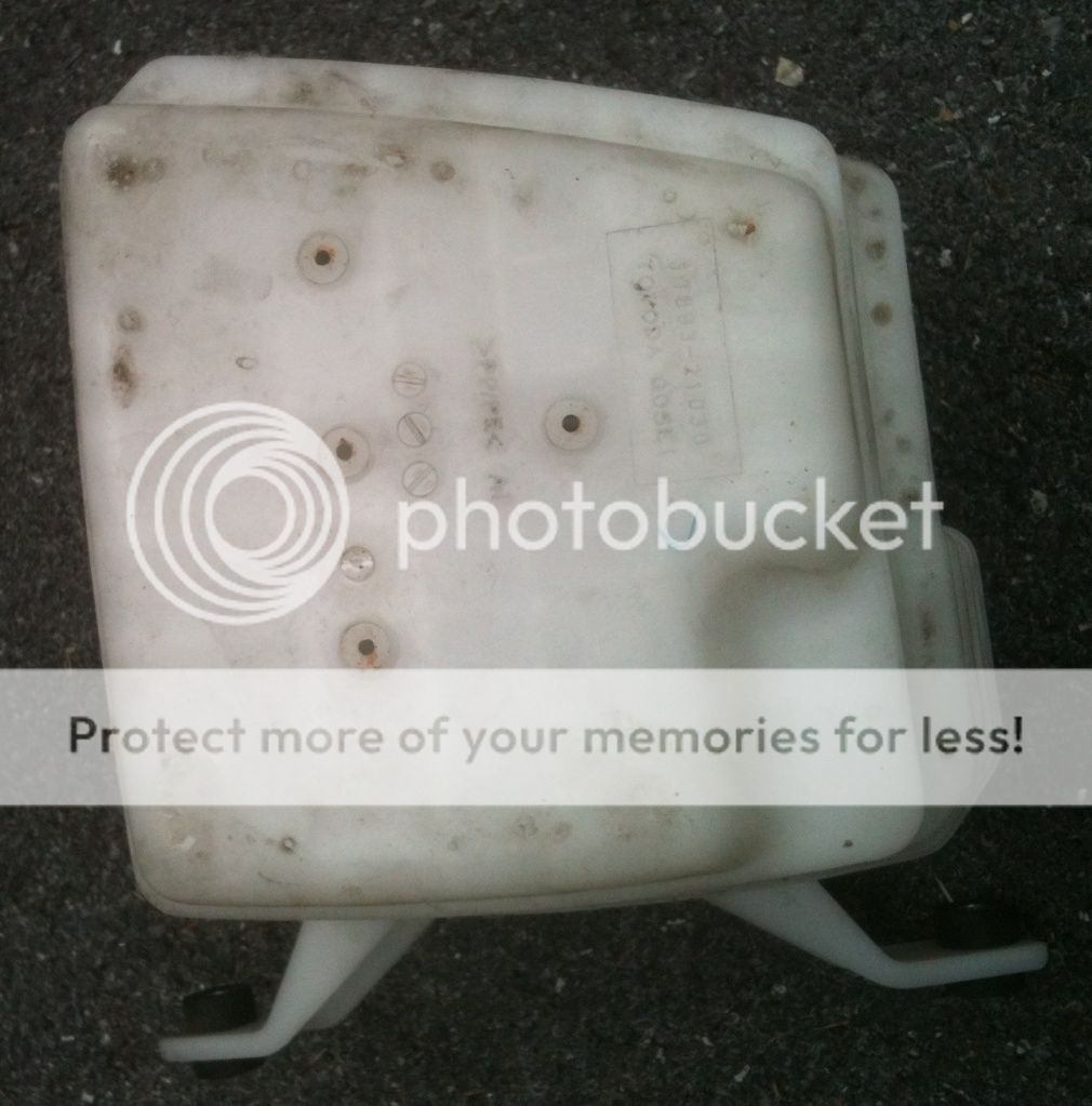

    The baffle I'm talking about is this (item #13): [​IMG] [​IMG] [​IMG] [​IMG]
    The last picture is the bottom of the baffle. Those 4 tiny holes is what the air is being sucked through, essentially choking the engine of air and power.

    actually, those 4 holes are water drains. the air inlet is in the engine compartment where part #11 attaches to #8. so it is sucking in hot air from just under the rf corner of the hood. #11 looks to me to be restrictive; pulling off #13 should allow more cooler air in, but heaven forbid you run through a deep puddle at speed. the filter probably doesn't like being wet, even if water doesn't get into the maf.

    Your "baffle", item 13 is called a resonator, more precisely a Helmholtz Resonator. They are normally plumbed into the side of an air intake system to tune out noise or sometimes to smooth out air flow at certain engine speeds. They don't restrict airflow because they aren't normally in the flow path. They may actually improve airflow over a narrow engine speed range by smoothing out the airflow.
    Those small hole in the bottom are probably just moisture drain holes.

    Dude I understand your excitement but really there's nothing there except a louder intake. Most cars have intake resonators. It makes them quieter and helps remove intake turbulence if you come off the pedal real fast or wot
    like 650 says.
