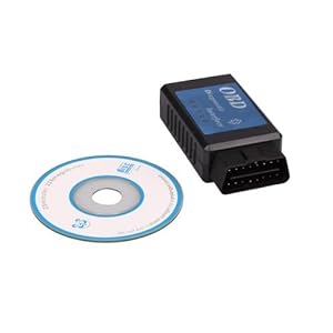

    I do plan on purchasing this OBD2 bluetooth adapter for multiple reasons other than just testing the intake mod. I have found that the ELM327 will work with the Droid app 'Torque' (Free version or the $5 pro) - its a heck of a lot cheaper and does from what I can tell the same thing.

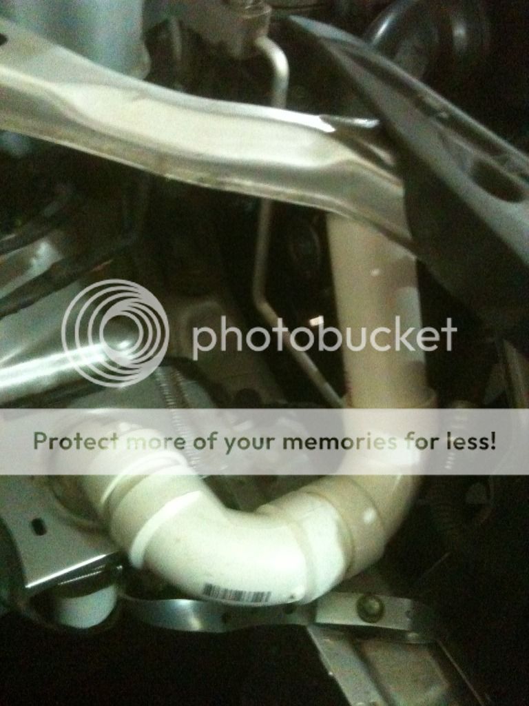

    So I fabricated a CAI, using 1.5" PVC piping, it ran directly from the air box into the open space behind the left front tire. [​IMG]

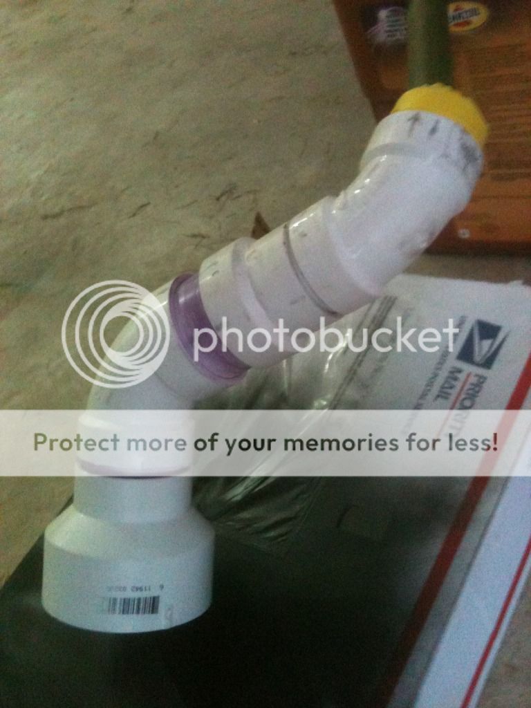

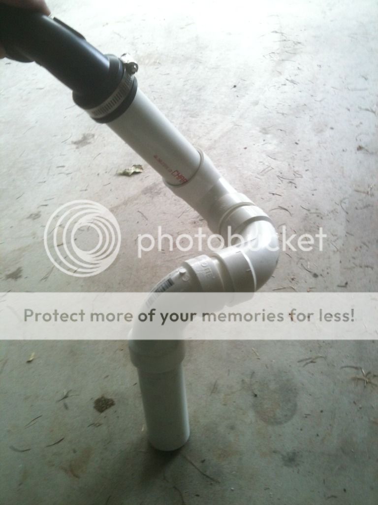

    I can confirm that there was no gain in power compared to simply removing the large resonator. I actually lost some acceleration with the 1.5" tubing. So I thought more about it... Using only the 1.5" pipe with all those 90 degree bends has to be a bit more restrictive and altering the airflow compared to the open stock tube (Tube, with snorkel, minus Resonator.) So I set off to make the CAI better...
    I go from 1.5" Tubing to 2" tubing to 3" tubing. Why not 1.5" straight to 3" tubing? - I had to use the 2" in order to fit through the precut hole where the OEM resonator use to be, space behind the passenger headlight is limited, and you have to snake it around the A/C metal lines.
    I have a k&n filter on order that will attach to the 3" piping. I'll still use both filters: the k&n on the 3" pipe, and the k&n drop-in filter that sits in the stock air-box. I'll send more pictures once the cone filter arrives.

    Yeah I wish I could dyno, or have a ODB-II iPhone app to track engine / throttle data.

    ANOTHER reason to not buy apple products. What about: Kiwi 2 Wifi - PLX Devices Inc - USA ?? 1/3 the price...
    ANDROID all the way. :) = ELM327 Bluetooth OBD2 Scan Tool $26 'Torque' app for Android $5
