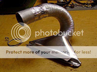

    The idea I have is to create something like the below...
    Using Daves idea to create a template..
    Attaching directly to the throttle body keeping the MAF in the same 'location' by using the below adapter... having this welded onto the aluminum piping
    Figure its a prob less than $100 total to fab up..I'm will to gamble that if it works beneficially, others can do the same mod... I'm willing to risk it :)

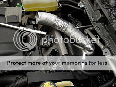

  7. tf4624
    tf4624 Active Member
    Dec 4, 2009
    527
    51
    [​IMG][​IMG][​IMG][​IMG]
    Your box/head mod should look like this

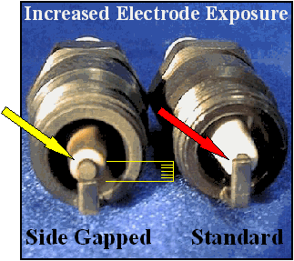

    Also consider indexing your spark plugs ..

    You can side gap it then.. same results and much easier then drilling a hole[​IMG]
    [​IMG][​IMG][​IMG]

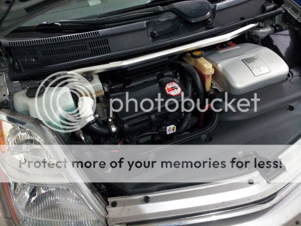

    Here's a pic of my quick and easy "warm-air intake"
    It's the rubber wide-sweep 90-Degree elbow from my original "cold air-intake" and a PVC 1.5" 60-Degree street-elbow.
    I'll report if there is any changes from the OEM intake with the resonator removed at the end of the week... Nope, didn't improve fuel economy. My mileage dropped from 47.3 to 40.4, I checked everything, the oil level was good, the tire pressure was good, I even raised the tire pressure to 44 psi in the front and 42 in the rear. My mileage slowly increased to 42.1. I thought it might have been the colder temps, so I blocked the grille - no change. Switched back to the OEM stock tubing without the resonator and mileage improved to 47.2 mpg.
    Justdidit likes this.
